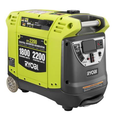

    I was looking for a on field solution to charging my RC lipo batteries. I initially thought of using Deep cycle batteries and was set to buy a pair when I came upon a Ryboi Inverter on craigslist. I've seen the honda ones before and was really impressed by how quiet they ran. But the $800+ price tag was way more than I wanted to pay. The guy was asking $300 for the Ryobi which much better obviously but still kind of high for me. Also, I was a little hesitant because, while I know Ryobi isn't exactly Harbor Freight, it also isn't a high end brand and was afraid on how long it would last. I looked at the home depot website and saw the 269 reviews which averaged 4 stars and decided to give the guy a call. I offered $250 since he was over an hour from me and he countered with $300 and he would deliver. Considering gas costs and travel time, I thought it was worth it. Met up with him at a local borg and bought it. It looked near new.
    I was a little nervous when I got it home and couldn't get the thing to start. I thought I had just made a $300 mistake. Come to find out the choke lever was just a little finicky and had to be set in just the right spot. After that it started right up and ran pretty quiet. Restart only required a single pull. It's a bit louder compared to the hondas from what I remember but it was a some time since I had seen them so I could be wrong. It's certainly not "quieter than a conversation" that Ryobi claims, unless you are constantly yelling (but not loudly) in your conversations. Its running power is 1800 watts which is more than what I need. It's very light weight and has good strong handles and a pull out handle to use with he built in casters. Overall I think the unit is well built and am very happy with the purchase.

          Thanks for the advice. I'll probably be using it almost every weekend for the foreseeable future so I think I'll think just mix stabil for now. Plus we don't have an off season in socal so I don't think I will have to put it in storage. On another forum, someone suggested using Marine Sta-Bil . Anyone know if there is a benefit over the regular kind?
          I downloaded a db measuring app and it measures around 76 db about 5 feet away and around 70 15 feet away. I wish it was a little quieter but am pretty happy with it.
