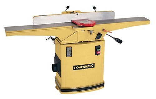

                As iffy as the guard looks, if it had a back on it then it would satisfy osha. I've seen plenty of guards that this one would be an improvement. Expanded metal guards give the advantage of being able to see if the belt is too loose, missing or out of align, and you don't have to take them off just to check these things. Now for the rest of the jointer. It looks like someone had good intentions and some nice thick steel. Too bad it is so short.
                  Looks like it imitates a jointer. But A real jointer has angled "Ways" which are able to be driven up and down the ways precisely to make small vertical changes in both infeed and outfeed height.
                  I see some angled supports but they don't seem to have any means to adjust them for infeed or outfeed height.
                  Is it just window dressing or a truly adjustable jointer?
ID:	787327Note the infeed and outfeed are both riding on an angled slope that can be driven up and down the slope to make small changes in height.
                  Also the infeed and outfeed tables are a little short?
