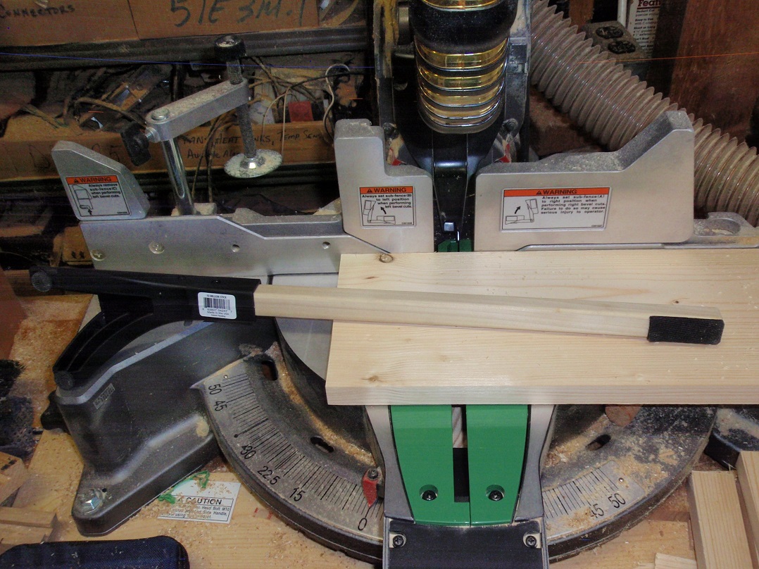

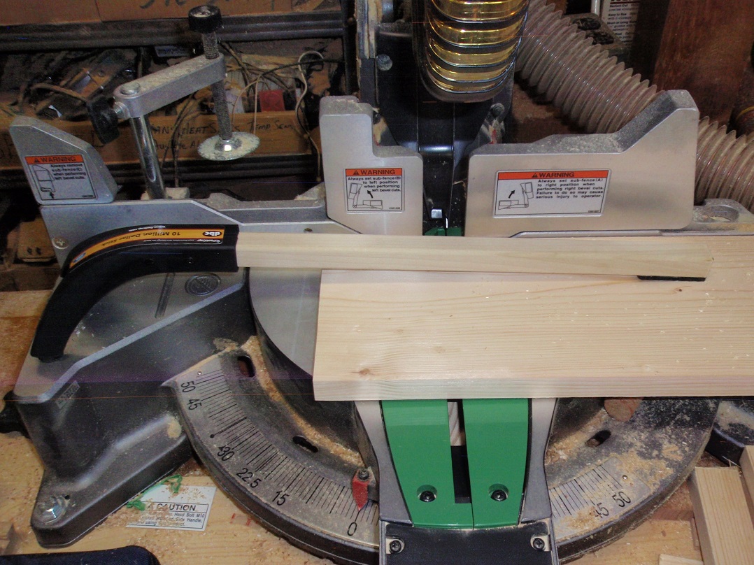

                    Initial comment:
                    Doesn't have the magnets featured in the video ad but upon review the catalog page doesn't show it either. Did you guys think it would come with magnets?
                    Also its so long it doesn't fit on the deck of the Miter saw like I originally envisioned when the tip is close to the blade.
                    My mitersaw setup has movable supports on a track which are rollers so it won't support the end of the stick. Gotta cut it shorter or put a semi-permanent flat support where it wants to land.

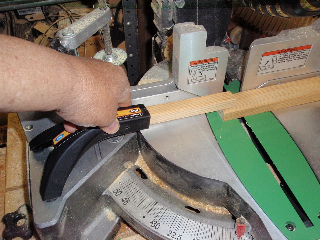

                            The articulated claw is the secret that makes it so you can push straight down on it to hold the wood in place rather having to apply force at an angle.
                            The long part is a piece of wood that is just screwed into a socket on the claw part - I think I'm going to fashion a short arm and try that out. One short enough so that one end rests on the deck of the saw while the other end rests on the wood on the same side of the blade.
                            The rubber foot that appears in the photos and video to be screwed into the arm has been replaced by a piece of cut rubber with adhesive backing, in addition to the missing magnets.

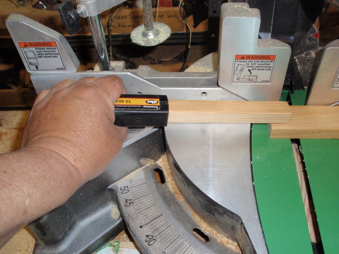

                              5 Million dollar stick
                              modified.... 5 Million dollar stick now
                              Cut a new piece of wood, it's 3/4" x 3/4"
                              Was 14 - 7/8" long, cut down by 7-3/4"
                              Hint - only the frontmost screw is in the wood. Don't need to remove the 2nd screw.
                              Added a rubber tip, hot melt glued on. (can't see it in the photos).
                              Three Before and Two after pictures.
