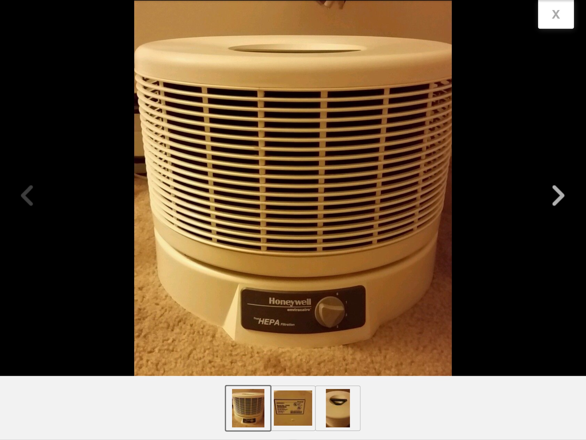

              Boy that went over my head! I use 2 Honeywell air purifiers that I picked up at yard sales for about $5 each. They are rated for around 350 sf rooms and have hepa filters rated for .3 micron. I see them fairly often at yard sales, probably from back when more people smoke in their houses and felt guilty about it. I keep a slightly smaller newer model, from yard sales, in my bedroom running all the time. Great background noise and the room doesn't seem to have any dust to leave notes written in on the dresser!

                • 3791
                Are you folks familiar with the air filters that folks put in the houses that I am talking about? Honeywell is the brand I am seeing the most of in yard sales. They are too good of a resource for our wood shops to overlook. The 2 I use in the shop are rated for 350 sf each. It may not be enough but better than nothing and a $5-$10 each a good buy.
                  Great idea I will have to look out for one of those as I cruise the yard sales.
