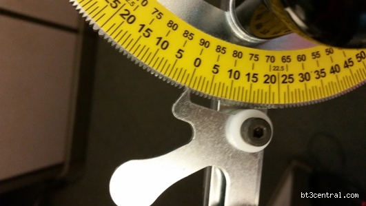

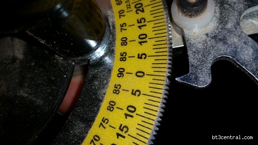

    Today I was getting ready to cut drawer front parts to length on my TS. I slid my Incra V120 miter gauge into the slot but then forgot something on my TS outfeed table and walked over there. I have an extension fence on the gauge and it extends beyond the left side of my TS.
    On the way back from the out feed table, I clumsily hit the end of the extension fence and I felt it move. I immediately looked at the gauge and the extra leverage was enough to bend the tooth at the 0 mark on the protractor as well as bend the single tooth on the lever that engages the protractor teeth.
    I switched back to my stock TS gauge but now I've got to figure out what to do with this gauge. Incra does sell a new protractor as well as a lever but their combined cost before shipping is over half the price of a new gauge. I think if I try to bend that protractor tooth back, it will snap off. The lever tooth may be more forgiving. Wish me luck.

          I was recounting my woe to my office mate who is also our machinist about what happened to the gauge. He told me to bring it in and he'd take care of it.
          The pics aren't too big, but all is right again!
          Before:
          After:
            I have always been invious of machinists. I wasn't around machinists as a kid, just wood and welders and cutting torches. He did a great job. Congratulations!

              I can't quite tell from the pic - how did he fix the tooth?
                He indicated the protractor was made of mild steel and used something to bend it back without it snapping off. He then used a brass wedge that matched the angle in the detent and lightly tapped it to make sure it was in the right spot. The fixed tooth looks shorter than the surrounding teeth so something else was probably done, but the little indicator tooth that engages the protractor fully engages it down to the bottom of the gullet like it used to.
                I haven't had a chance to check it out on the saw yet. I will probably need to zero out the gauge again to my TS blade so at least I know I'll be cutting at 90deg just fine. I'll then have to check how I do at 45deg.
