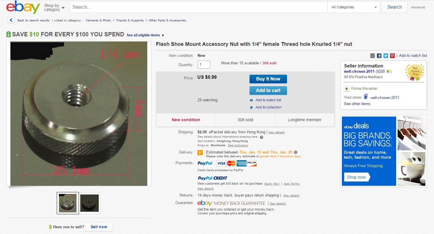

                        • GregW
                          • 17
                          maybe something like this 1/4-20 knurled knob would work..
                          http://www.ebay.com/itm/Flash-Shoe-M...item2a3e2103b2
                          • radhak
                            • 3061
                            • Miramar, FL
                            • Right Tilt 3HP Unisaw
                            Thanks - that works well, particularly because all the dimensions are listed!
                            - Aristotle
