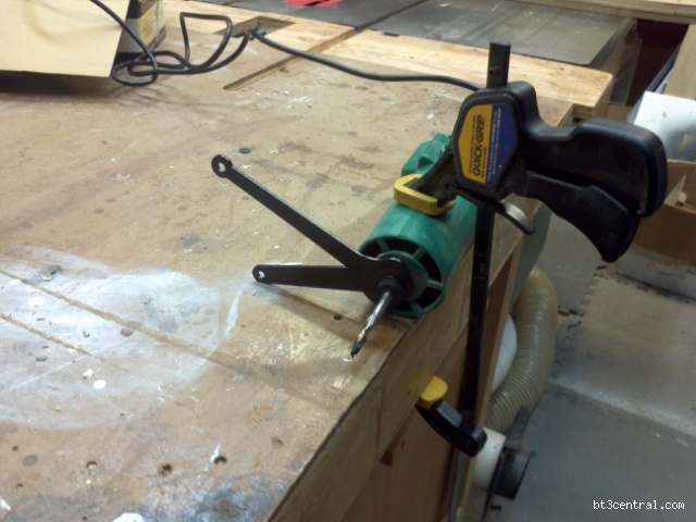

            I've done a variation of what Loring is describing without the vise but the vise is definitely a good suggestion. If you can get the base off, do that first. Slip the spindle wrench on, then lay the router on its side with the wrench pressed on the bench. Then slip the collar wrench on and try to press down while holding the body of the router steady. I haven't been as stuck as you describe but this works for me if I can't manage to squeeze the two wrenches together.

                (Paul, that pic is so funny - that could be my bench right now, with my attempts to get this thing out )
