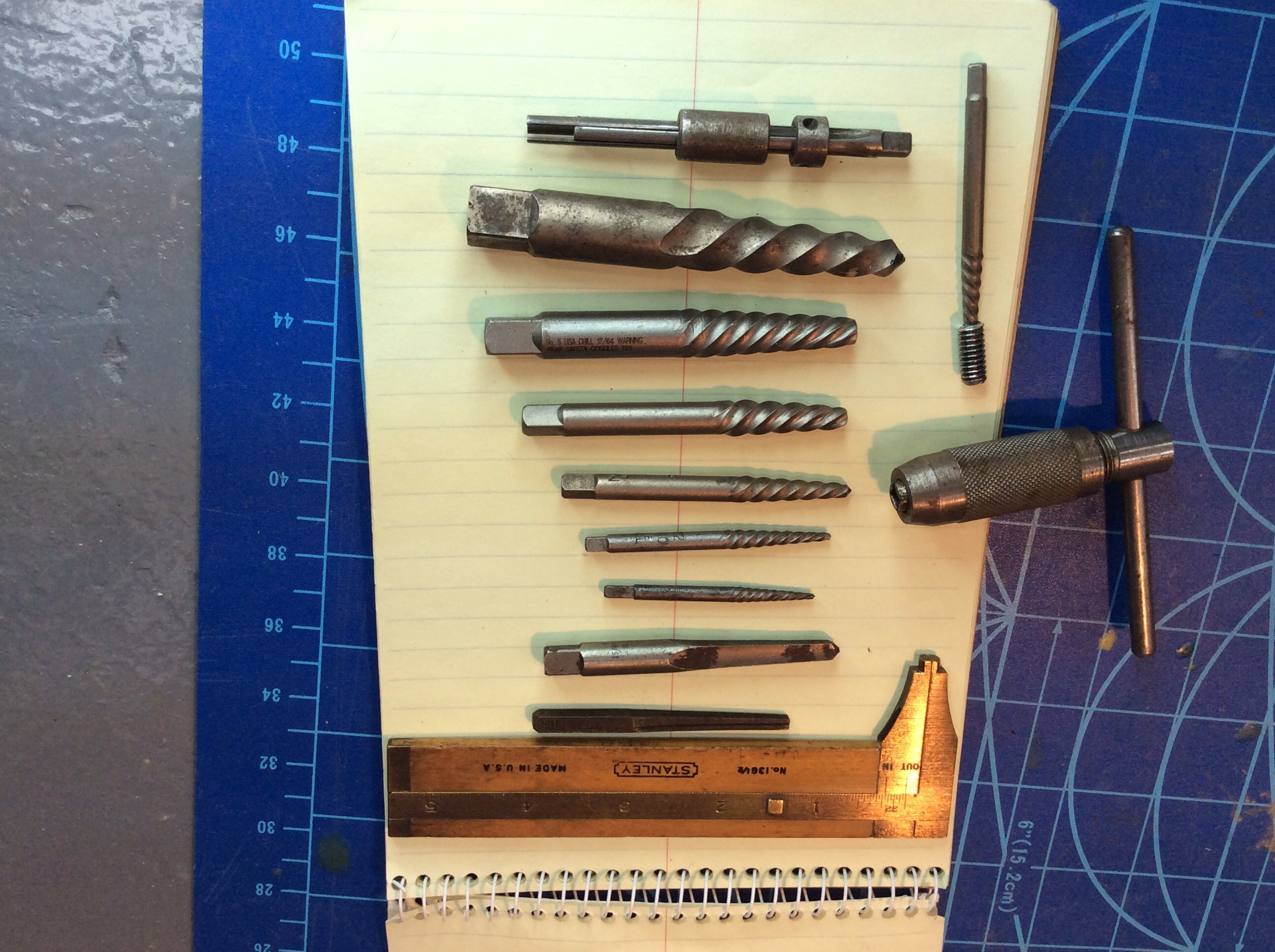

                            This thread jinxed me. Have not had to deal with a broke off screw/bolt in years. This morning I was removing the motor to my powermatic table saw looking for a mysterious rumble when the saw powers off. Putting it back together the 1/4-20 bolt for the motor mount pivot shaft broke off when tightening it. It was a clean break and did not appear to be a hardened bolt. A quick drill out and tap in a reverse thread extractor quickly eased out the remaining piece. Now if Pappys photo shoot thread will not jinx me. I can stand a broken fastener a lot better than a butt-light.
                            Photos of screw extractors, and the bottom tool is a 3 fluted broken tap extractor. May you never need one!
                              • 3774
                              Correction
                              Dang jinx still at work, photo is upside down, top tool is the tap extractor.
