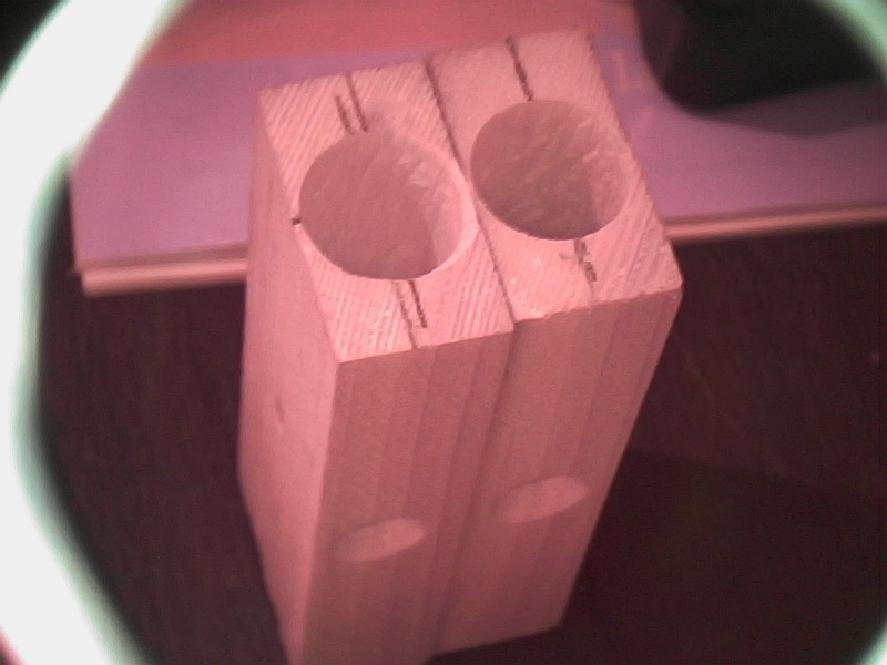

    wow i impressed myself.
    Here i drilled a 1.5" deep 17/32" hole in a 9/16" thick piece
    If you calculate that leaves a 1/64ths thick wall in either side providing you drill exactly in the center AND you keep the bit and the workpiece precisely parallel...
    Came out almost perfectly.... It broke out the side just a little on one of them at the very bottom.
    Procedure:
    Make sure to cut the pieces squarely as possible so the ends are perpendicular to the length.
    Mark the workpiece center from both edges so you can identify the exact center as halfway between them if they don't coincide because your measurement is not perfect or you set the square off just a hair. This requires four marks on the each end.
    Use a 1/2" brad point bit as this will ensure the center location and also prevent wandering off on the end grain which frequently happens. Besides I don't have a 17/32 brad point bit.
    Clamp the work in a 8" wooden handscrew clamp laid flat on the DP table. This will make the sides of the handscrew clamp perpendicular to the table surface lining up the work. Make sure the end of the workpiece is lying flat on the table and there are no wood ships under it before clamping into place.
    Drill out the hole to 17/32 using a bit bought purposefully for doing oversized 1/2" holes.

          What about starting with thicker stock, drilling the hole, and then ripping (or sanding or hand-planing) the stock to final width on either side of the hole? That way the drilling operation, with the potential for bit walking and/or wobble, doesn't have to be so precise/exact. And if the hole doesn't end up exactly 90 degrees to the sides you can use a taper jig (or hand-plane) to adjust the workpiece sides to match the hole.
          Though what you did is a pretty good test - "can I do this?" and "are my drill press settings accurate?"
          mpc
            • 22109
            mpc
            I find that the more operations the more chance for errors that eventually add up. lets say you randomly center the hole and then try and rip to proper centering and width there are two independent rip setups of which there are lets say .010" errors giving a total of .010 in final width error and .020 in centering errors...
            Besides, I had this scrap that was 9/16ths wide and a perfect length and I was too cheap to use a bigger scrap, haha. I figured it was a good test of skill and if it failed I would get a bigger scrap.
