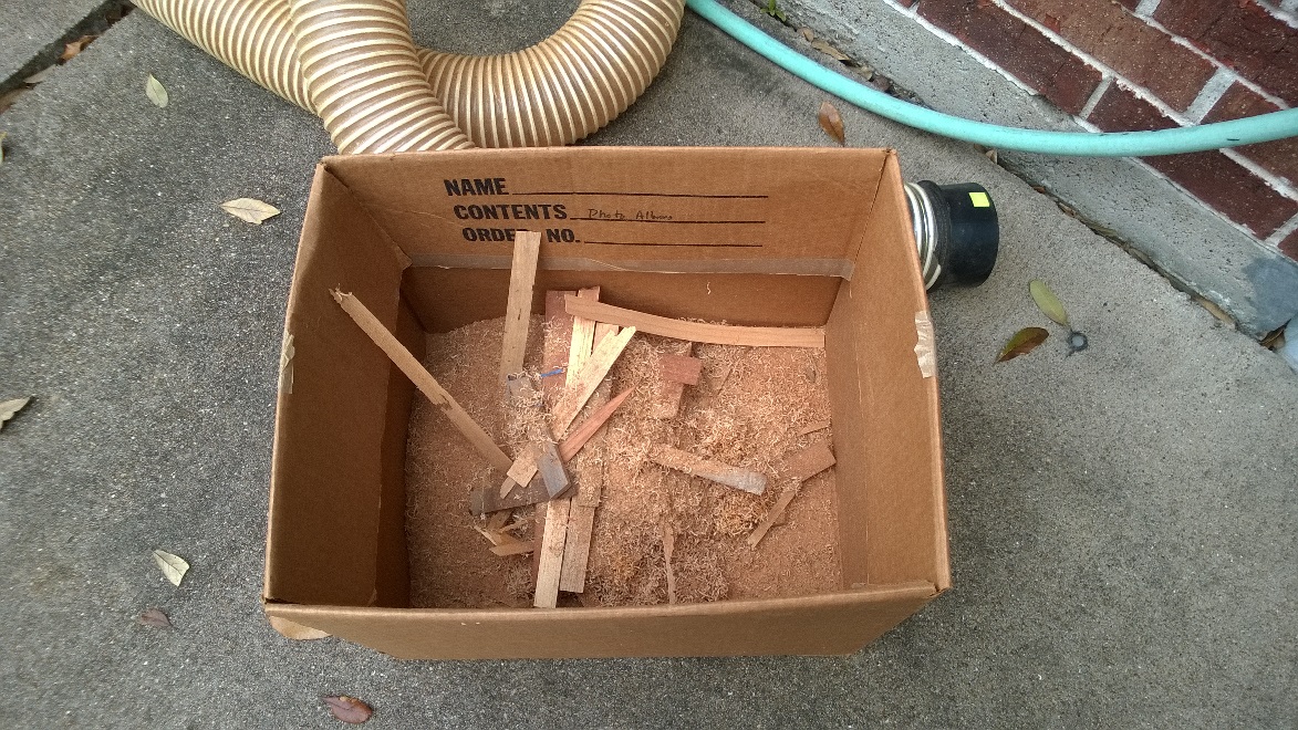

    Too lazy to install the ZCTP. Ever wonder what happens to the skinny cutoffs when you rip pieces to final size?
    They fall in get sucked up and clog up your DC hoses... this was in my 4" hose from the rear BT3000 dust port and the stuff in the box is what I was able to get out of it. The sharp bend I have in the hose probably didn't help any.
    Seemed to be lacking suction. The hose to the belly pan was OK, though, just the one sucking the BT3 dust shroud caught all the cutoffs (if it not a crosscut but a rip cut, are they Ripoffs?).
    Culprit is a lot of cutoffs about 5-7 inches long and 1/8" to 1/32" thick by 3/4" wide. Longer than that they stick up and can be pulled out. Shorter than that they can make the curve and pass thru the 4" hose bends.
    I was using the original metal throat plate but guess I really need to use the ZCTP I have...

    Yep. Had the same thing happen the first week I used my saw.

      I was trimming some polycarbonate and it had some long thin cut offs. Rip offs rather.
      I shot two of them out the back port right through the bend in my 4" hose. It took some force to do that.
      I installed an elbow there instead of just a plain hose with a bend.
