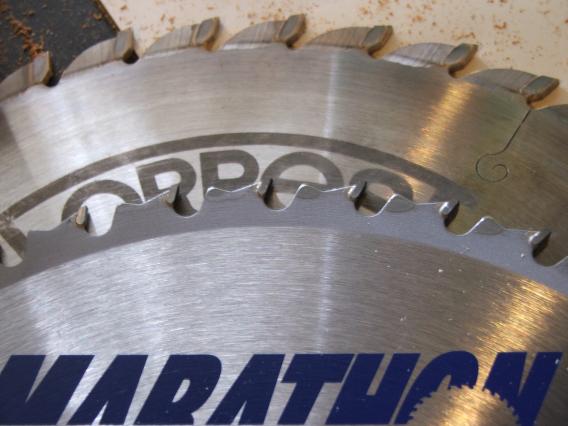

                Funny, in 2005 I did a pictorial comparison of the Forrest WWII and the Irwin Marathon 40T, and the WWII vs the original Freud/Ryobi 36T blade. I just replaced the lost pictures.
                The thread is very apropo to this thread's latest direction.
                Here it is:
                http://www.bt3central.com/showthread...=8937#post8937
                and I copied the pics here too (click on them to see larger):
                Look at the size of the dang carbide tips in comparison!

                  The Irwin Marathon is pretty much a construction caliber disposable blade....softer carbide, smaller teeth, made to a lesser standard, etc. IMHO you're far better off buying one decent blade for close to the same $25....Irwin Marples, Freud Diablo, CMT ITK Plus, DeWalt Precision Trim, Oshlun, Avenger, and many good closeouts are typically pretty close to the cost of a 3 pack of cheaper blades. They'll last longer, perform better, have a better manufacturing process, better materials, and are worth having sharpened when the time comes. I love that pic Loring posted....it speaks volumes.
