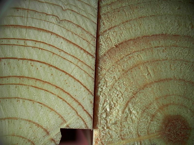

    New Hitachi 12" miter saw finally set up, replaced the original equipment 32-tooth blade.
    Last year I bought a Lowes close out - a CMT P12096 teflon-coated Alternate Top Bevel (ATB) 12" 96-Tooth for about $13 bucks. Wish I'd bought several.
    Here's difference in the cut:

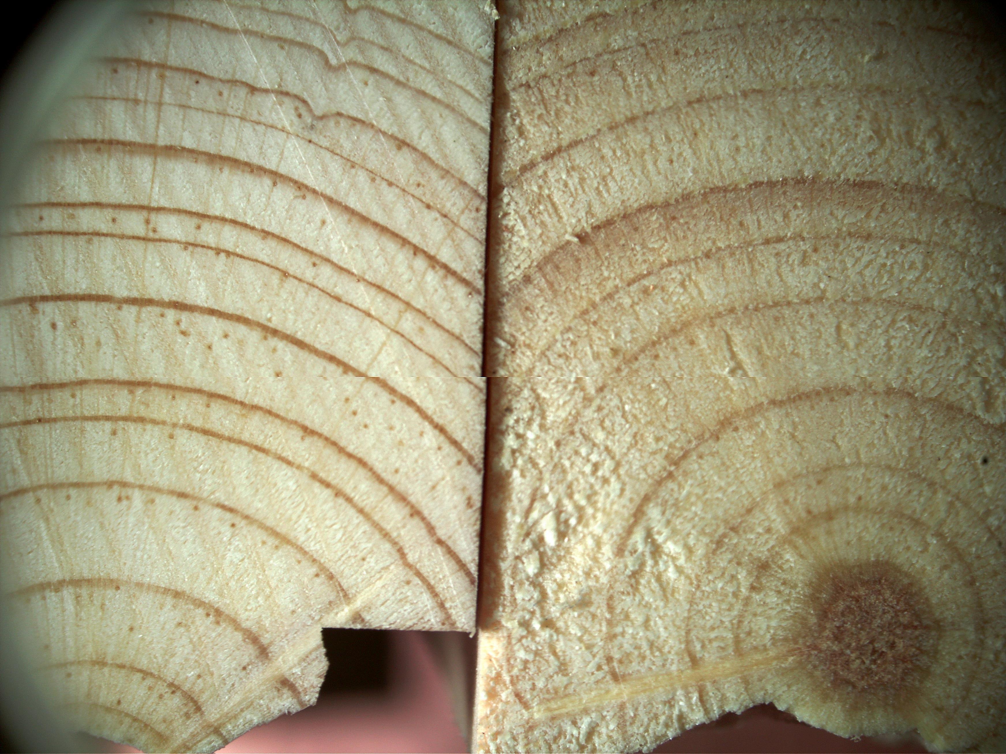

    I took the picture with my Aven digital microscope. I used both the built-in ring lights plus some side lighting so that the finish/flatness differences would be obvious. The 96T CMT blade is on the left and the 32-T Hitachi blade is on the right. Its the same piece of wood, ripped in half and folded so they are side by side. I then cut a fraction of an inch off the end of the one on the left to get a different cut surface. Lined up the two faces so they'd be in the camera focus plane. Second picture is a higher resolution photo if you want to blow it up some more.

    That CMT was a great buy at $13!! Good, clean blade makes a world of difference.

      That does look very smooth and it looks like the arbor is true as well.
      I have a but, however.
      There is a lot more surface on the right side for a glue joint. It would probably result in a stronger joint.
      I have also experienced glass smooth cuts when installing new blades. It lets you know things are working as they should with no play.
      Another benefit of such a nice blade is that there is very little chance for excessive tearout. It slices so well, that extra prep against tearout is probably not required.
        both blades are brand new.
        Maybe I should keep the cuts as a reference if I think the blade needs sharpening. That's usually a problem for me, I use a blade for quite a while and I think its OK but then I put a new one in and I say, oh my, the old one really needs sharpening.

                wow - great illustration!
                I put a 40 tooth Freud blade on my BT - and it was a whole new world.
                (that was my impression, anyway)
                Your images prove it -----
                    Butt joints are not that good glued anyway since the end-grain -long grain glue does not hold well allegedly. long grain to long grain glue joints are much better. I suspect part of the problem is that the end grain sucks the glue our of the joint which would be exasperated by a rough joint? Supposedly the way to get a better glued butt joint is to spread some glue on the end grain and let it dry then reapply some glue and make the joint.
