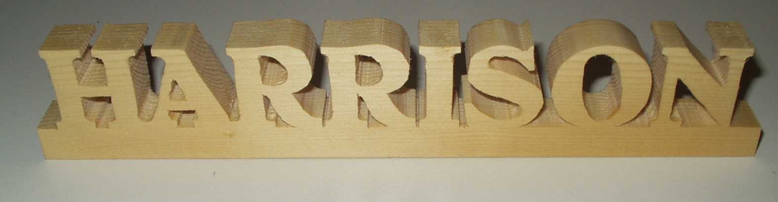

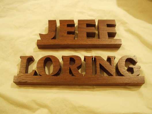

                          a scroll saw is a fun thing to have, you can make a lot of personal items with it that you can't make with a bandsaw, I've used mine to make a number of name plates. other people make nice stuff, like inlays and intarsia, also good for toys and small intricate items.
                          A sander is very worthwhile. I my self prefer the benchtop 6" disk 4" belt sander combos over handheld. The handheld ROS are good for finishing furniture and stuff - their claim is that they aren't too aggressive but make a sanding mark-free surface,
                          The benchtop combo is what you need for precision sanding... it has the miter and table and stops to make right angle perpendicular square sanded surfaces and rounded corners. As well as perfect 45° or other angle chamfers and stuff. They're more aggressive for shaping and corners than ROS.
                          I also have a oscillating spindle sander which is great for making curves. And a 1" benchtop belt sander for detail work.
                          And yes I do have a handheld ROS and a Sheet sander.
                          If I had to give up the scross saw or the belt/disc sander, It'd probably be the scroll saw. Because you use the sander for so much stuff. But I do use the scroll saw and its fun.
                          As for the specific saw, $50 is a pretty good buy - I think a VS 16" scroll saw is usually over $100. The features I'd look for in a scroll saw are VS, pin + pinless blade capability, blower. That unit appears to have all of them. What you can't tell is how well its executed... is it smooth and vibration free, does the hold down work well, etc. I'm sure there's a return policy if you don't like it, at Sears, no?
                          Final thought: A scroll saw would be for stuff you wouldn't otherwise do. A sander, well, its a sander, you use it for all the stuff you do. Its basic, a scroll saw is special.

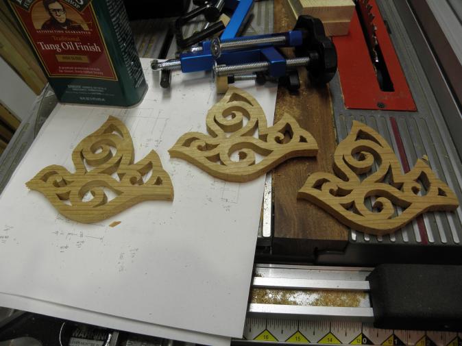

                            Nice work! You have a lot more patience than I do. :-)
                            I have a Ryobi scroll saw, and for as often as I use one, it is OK. I think I just prefer to make almost anything except items that require a scroll saw! I did make a couple ornaments when I first got it, but it sees very little use these days. My passion these days is wood turning. I bought my first lathe just a couple years ago, although I've been a woodworker for 40+ years.
                            One of my favorite tools in my shop is the Ridgid oscillating drum/belt sander. This tool is just amazing! I use it a lot. I have a small Dremel 1" belt / 5" disk sander, and it was bought mostly for hobby use, it is a bit undersized to be real useful in a wood shop. I wouldn't mind having a large disk sander -- like a 12" one, but so far not enough true demand to actually go buy one.
                            My woodworking use model has changed significantly lately. I was going to get a SawStop cabinet saw, and decided to get a Festool track saw instead. (Primary need is breaking down plywood for cabinets.) Awesome saw! I'm hooked on Festool, and a Domino is next on the list, probably an early Christmas gift. I always manage to buy nice things for myself at Christmas-time that are just what I wanted ... :-)
                            And I've also learned to get my wife something nice too. And then make her stuff, or remodel yet another room.
