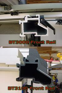

        BT3000 vs BT3100 front rail profile difference.
        The difference is the black BT3100 rail has a longer front stoop that dips farther out and lower
        The top, back, and bottom slots all still line up between them..
Name:	BT3000 vs BT3100 Front rail differences.jpg
