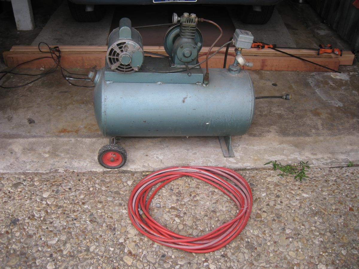

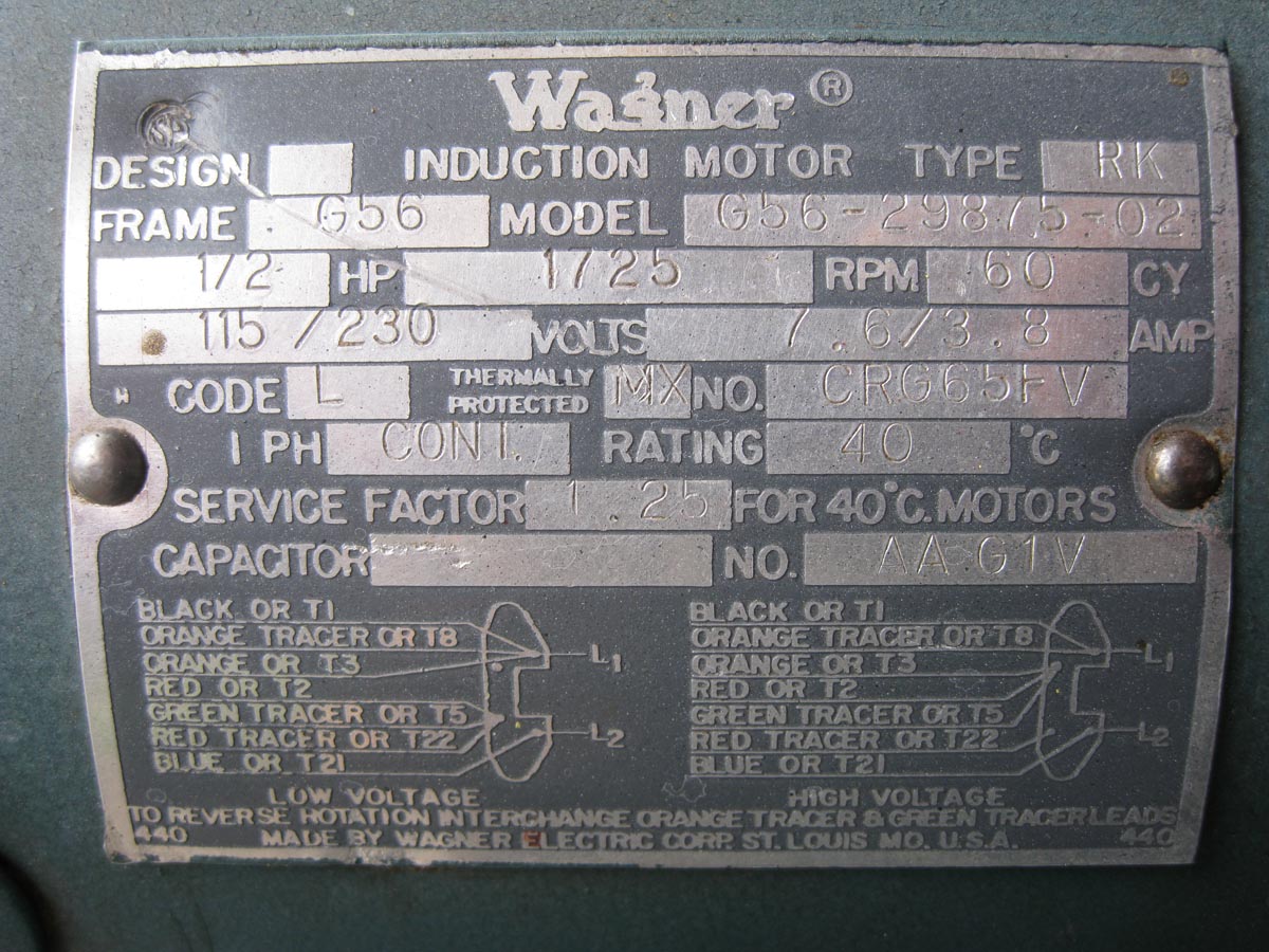

    I picked up an older 20 Gallon compressor Saturday and I haven't been able to find out anything about it online yet. I thought it was 1 1/2 HP when I looked at the motor plate, but it is only a 1/2 HP Wagner motor. I don't think it is going to put out the CFM that I wanted, but it sure does run quiet though. I have a Porter Cable 4 gal Jetstream Side Stack and it is really loud, extremely loud.
    My new compressor is oiled. I don't know anything about these types of compressors. The dipstick shows full. My neighbor took very good care of it. Is there anything I should look for and/or do maintenance wise? The motor also has a couple oiling caps. I wish it had a petcock for draining.
    I think I got a decent deal. The lady preparing the house for an estate sale offered me $85, which I thought was great for a 1 1/2 HP (or so I thought) old steel. I accepted the offer (I hate dickering). I ended up offering $100 for the compressor and about 50 board feet of wood (mostly white oak).

    That's not too bad a deal you got Eric.
    And with the amount of BF of oak, you did fine. I think you should do okay with the CFM on that unit, unless you're going to operate several pneumatics tools at once.
    I like the white oak guard dog you have protecting your investment! He'll tear a leg off for sure!
      That looks like a good old one. Not much maintenance to it but changing the oil, and cleaning the air filter. You might just take some soapy water around all the fittings to check for leaks. Check the gauge to see where it cuts off.
      I'm surprised to hear it has a dip stick. Most just have just a removable fill plug that allows a view into the crankcase. I'm also surprised it does not have a petcock for draining.

        That plate seems to indicate mostly motor data... is there another plate on the tank or perhaps on the base of the compressor itself?
        Oil-lubricated compressors are traditionally cast iron, at least for the cylinder and running gear parts. These provide significantly longer life (3 to 4 X) over non-lubricated aluminum units.
        Did you mean that there was no "petcock" on the tank, for draining condensate? If not, you should check the tank for water, and I might even go so far as having it pressure checked.
        (I just did a Google for "Wagner G56 compressor" and got this motor on E-bay: http://www.ebay.com/itm/WAGNER-THREE...-/140346881643 )

          The HP rating of the motor is really not that relevant on a compressor. All it has to do is spin the head pulley at the required RPM. I have a Sanborn Black Max oiled compressor similar to this one that was bought in about 1982 and is still going strong.
            The HP is quite important for the performance of the compressor. Provided the compressor itself is capable, a certain HP level is required to put up so many CFM at so much pressure.
            There not being that much magic in compressor design, generally a 2 HP motor (around 15 Amps at 120V AC) is the maximum that can be run off a residential circuit and that in turn can power a compressor to a maximum of around 2-3 CFM at 90 PSI or around 4 CFM at 40 PSI. The specs vary a bit from make to make but that's the range you will find.
                The motor in the link is listed as a three phase motor.
                  If the compressor works well, it might be worthwhile to take it to a compressor repair shop and have a drain/petcock installed.

                    There is hardly any other identification on the compressor other than the motor plate. There is an embossed X2-27 on the cylinder casting and also stamped K2 under it. The rear crankcase plate has 6973 stamped on it.
                    The intake filter is just an oiled disk. Probably ought to upgrade that, especially if I move it to my shop. How often does the oil need to be changed?
                    The Square-D pressure box reliably cut the motor off at 100 PSI (which was the max on the pressure dial) and on again around 40 PSI over several cycles. It doesn't have an on/off switch. I was using a couple extension cords to turn it off and on while I was standing on the other side of a brick wall during initial testing. I was getting a little nervous as it was approaching 90 PSI. It took a while to fill, but I'm just used to my little 4 gal. compressor.
                    There's a big plug on the bottom. A 13/16 wrench fits it, but I couldn't get it to budge. It looks like the previous owner used the bigger plug on the top end to drain it, as the end near the wheels had a lot of the paint chipped off and scratch marks. I don't have a 1 1/2" wrench for the top plug. From the teeth marks it looks like someone used a pipe wrench on it.
                    I'm sure it will work great for my nailers and staplers, and maybe finishing once I get a gun. I was really wanting something to drive my pressurized sand blaster easily. During testing I was using some high CFM tools like my air gun and die grinder. I didn't expect the compressor to keep up with them, but I hoped it would have more then it did.
                      You could squirt some WD-40 on it. Let it sit. Use a heat gun on the surrounding metal, and/or ice up the plug, and take it out. If you have an adjustable wrench and a breaker bar you could get some more leverage. You could also use a galv pipe as a breaker bar. If you get it out, you could get fittings to downsize (if need be) to install a petcock.
                      How much you use it would depend on the frequency of oil change. For occasional use I would do it every six months.

                            Don't get to discouraged with the HP rating on the motor..
                            Remember this is most likely a true 1/2 hp motor rated to run at that load all day..
                            Going by the plate specs it stacks up with a Baldor 1/2 Hp motor
                            Most of today's equipment is rated at max amps and peak power.. Not continuous..

                              The pressure sensing switch cut the motor off at 100 psi and didn't restart it until the tank ran down to 40psi? That's a pretty wide a spread; wider than any I've run across. 100 & 80 psi are more typical trigger points for older compressors designed to run typical "90 psi rated" air tools; many current compressors turn off at 125 or 150 psi and back on well above 100 psi. With the unit unplugged, see if you can open up the control switch/module and give it a cleaning. It probably has some dried gunk jamming it a bit.
                              Does the compressor have any safeties? Look near the top of the tank for a "pop off" type of pressure relief valve; when the tank is nearly empty grab it and tug on it (most have a small ring just for this purpose) to make sure it a) moves easily and retracts properly, and b) that air flows out of the tank when you pull it open. If it doesn't have any such relief valve I'd "T" into the line between the tank and regulator and add a 125psi pressure relief valve of some sort. One designed to replace a water heater relief valve might work.
                              Another trick for separating rusted together or otherwise jammed together nuts/bolt/plug deals: heat from a torch (MAPP gas torches are hotter than propane and reasonably priced) around the frozen plug to expand that metal and then rapidly cool the nut/plug by spritzing it with water or carefully holding a sopping wet rag against it. Just don't touch anything with your hands/fingers! I do this as "try #2" if the torch alone isn't enough to free the parts. PB Blaster is another good penetrate, Toyota parts departments sell a spray can that's legendary. If you use a big breaker bar, or breaker bar + pipe extension, be careful you don't distort the tank itself. If you really need that much leverage, it might be worth it to haul the tank to a car repair garage and ask if they'll try their impact gun on the plug. Impact guns "hit hard" but in short bursts that don't stress the tank as much... and the sudden shock/vibration helps break the parts free.
