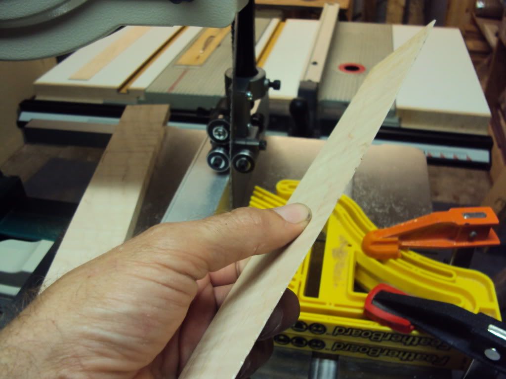

                  Thanks guys! It took a few days, but the saw is now set-up according to the very well written manual, including adjusting for drift. After spending a few years with my first bandsaw, a little Ryobi BS-900, it's like going from a pinto to a ferrari. One of my goals is to cut veneer. After the set-up was complete, this was my first attempt. (By the way, those are JimD's extension tables in the background, a quantum leap for that saw IMHO).
                  [IMG][/IMG]
                  Granted, this is only 2 1/4" hard maple. But with the Woodslicer blade from Highland Woodworking, the cut side is actually so smooth I think it's glueable as is.
                  Now here's where I was really surprised. This piece is 0.040 thick from one end to the other, and measured on both sides. It never varies more than a few thousandths and that was probably caused by variation in my feed rate. Square on four sides. I am extremely happy with this machine.
