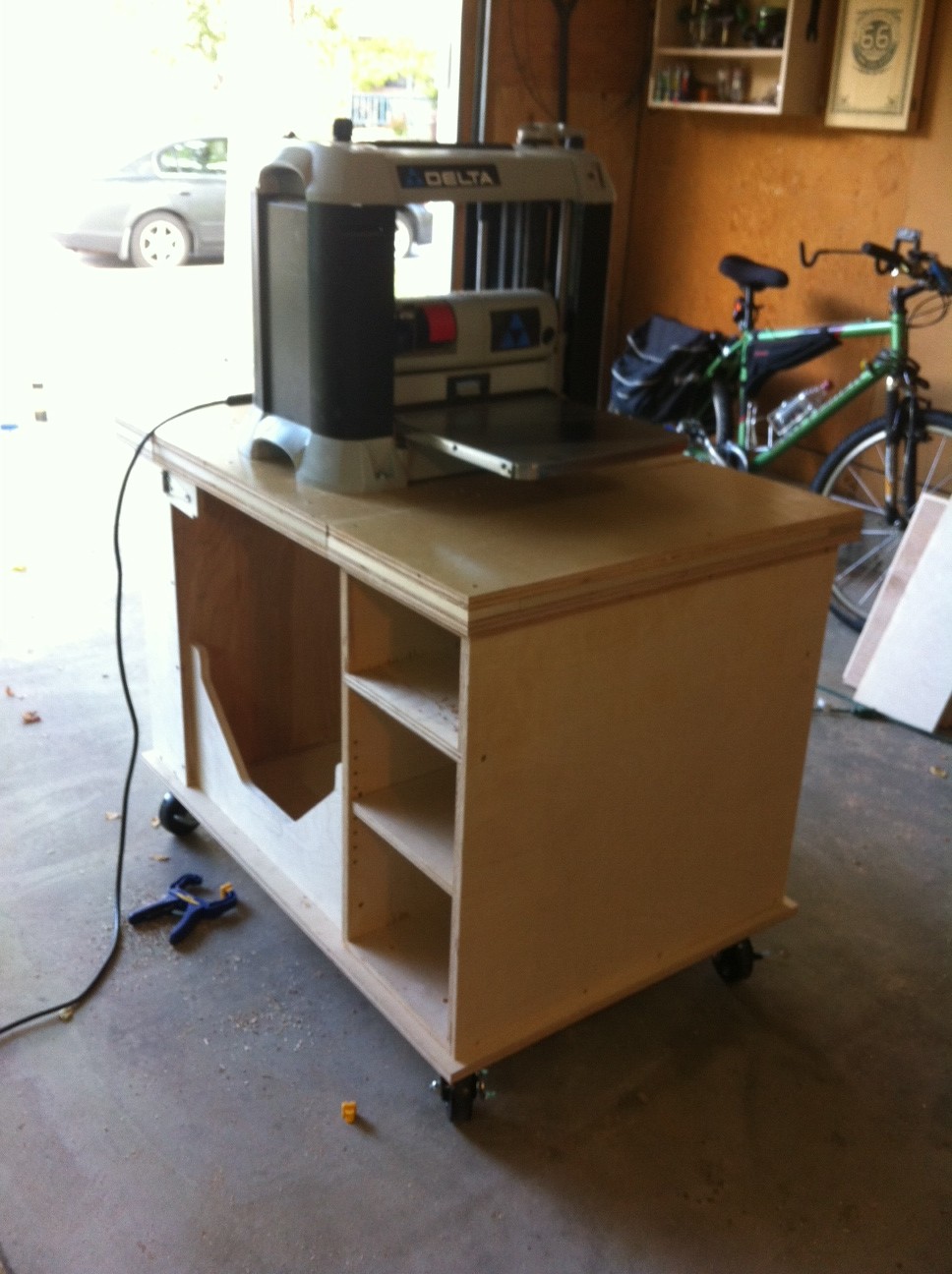

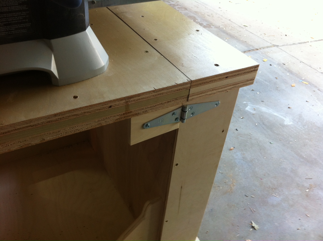

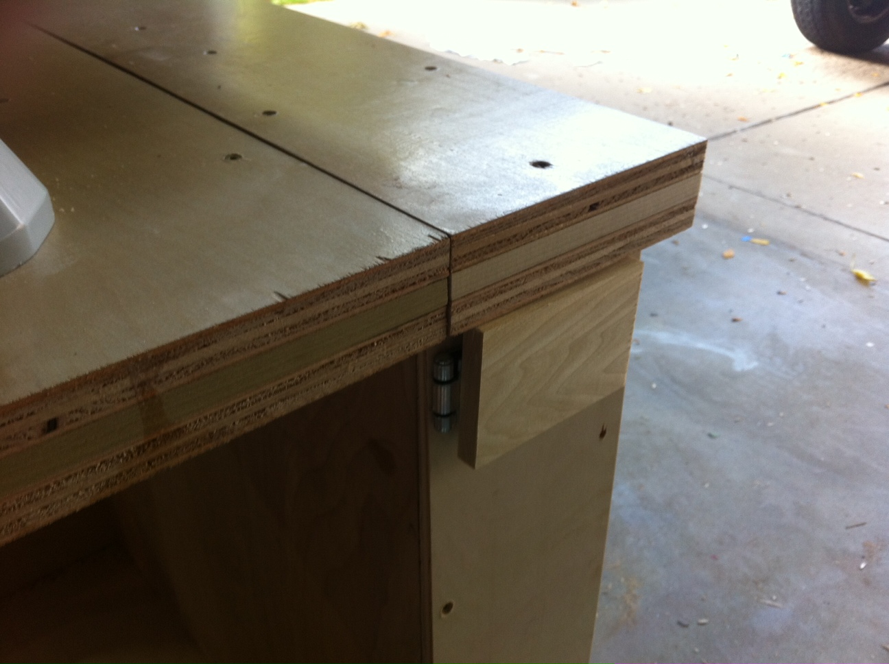

          Ok, got it finished! It actually works pretty well. I made a small adjustment to the locking part of it. I moved the supports to the underside of the bench, instead of on top. That way when the planer is flipped over I have an unobstructed work surface. I plan to get a couple of barrel bolts to lock it down as well.
          Overall, really nice project. A little more expensive than I would have guessed it would be (I'm guessing around $200), but a very large upgrade from what I had before.
            Looks good. I agree with adding a better locking system. A planer can vibrate enough to shake those flip board loose.
                That came out really nice. I am a bit shocked at the cost though. I guess it uses a bit more hardware / wood than the Shop Notes versions I am planning on. Of course the one you built has a lot more storage space it seems...

                  Cubsfan,That looks really nice. I agree the barrel bolts should do the trick for keepin it more secure. Great job

                    My problem is that I didn't really try too hard to minimize cost, since I didn't think it would be too bad. I was wrong
                    It was something like:
                    2 3/4 Plywood sheets @ $45 = $90
                    4 Locking Swivel Castors @ $13 = $52
                    1 Piece of 2x2 3/4 plywood @ 10 = $10
                    Wood for the webbing ~ $30
                    Those are pretty close estimates, so I'd say around $180 I guess? Buying the castors from Amazon and getting the $25/sheet plywood would have probably dropped the cost to around $110 or so I'm thinking.
