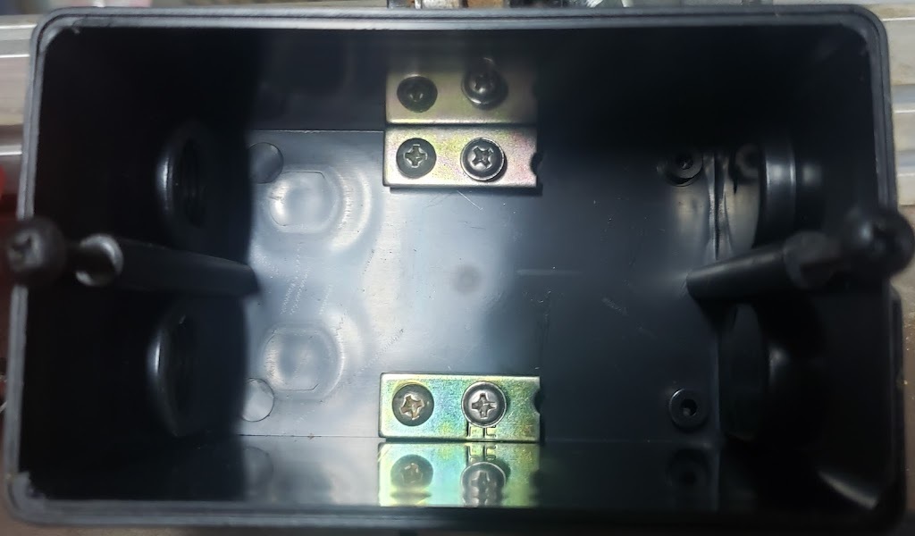

                        So here is the pic of the box. You can see the 2 bus bars, one is marked what looks like PE or something, the other is unmarked. I am thinking, perhaps incorrectly which is why I ask, but line comes on, gets connected to the switch, ground to the unmarked bus, Load comes in on the other side gets connected to the load side of the switch, and... ground connects to, the PE marked bus?

                          • 22031
                          Looks like PE, not PF. You can see the lower bar making it an E.
                          PE may means Protective Earth.
                          Which is separate from the Ground in the three wire house wiring system.
                          I'd just leave it unconnected.
                          Connect both your tool load side ground and the line side ground to one bar; leave the other (PE) unused.
                          If for some odd reason you had a local ground connection as in a Faraday cage or something you could use the PE bus for that.

                            • 9533
                            So not on the PE connection, that kind of leaves by default, tying both together and the grounding bus bar. The original configuration had the grounds tied together AND bolted to the stand of the saw. I somewhat doubt that will work well for me, but I am figuring on instead of removing the motor to get to the wire box, I was going to go back with the orignal switch box, and make my wiring connections in there by wire nutting, or crimping the connections together, I could make my stand ground at that point to keep the mechanics of the saw grounded, but doutbe I need to do that...

                              • 22031
                              Since the PE bar is not connected to anything but just floating, you can freely use it to extend your ground bar if you wish. But in reality, jumpering it to the other ground bar uses up one screw terminal on each so I don't see any gain. If you want to ground your table frame then you will probably be best putting two wires under one of the screws.
                              Or the ugly solution of three wires into one appropriate sized wire nut. Three of them the incoming ground, load ground, and the table ground and not using the bar. which is apparently not connected to anything.
