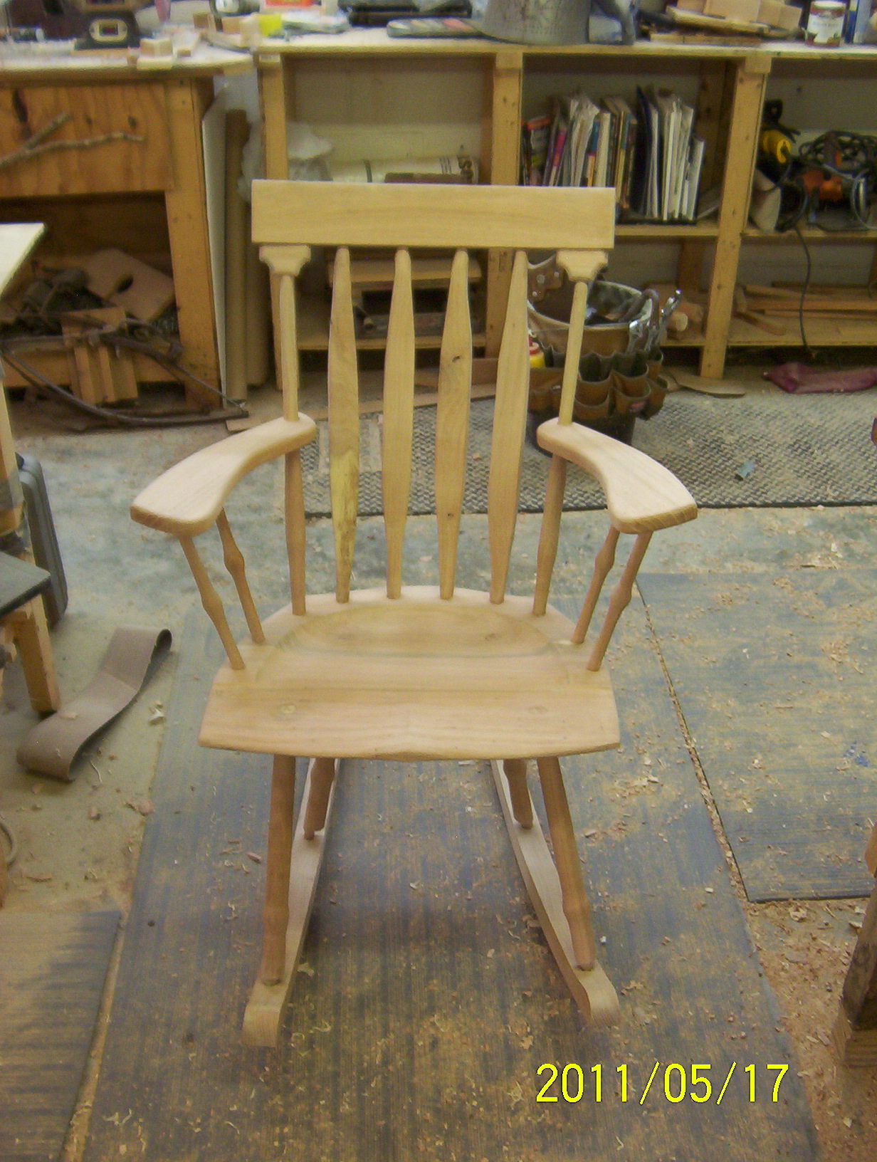

                My wife brought some ammonia home tody from of all places - Walmart. I doesn't say what the percentage is ammonia but I built a fumming frame and I put the rocker in it and I'm letting it cook. Here's a before picture of the rocker and I'll post an after picture if I have any results.

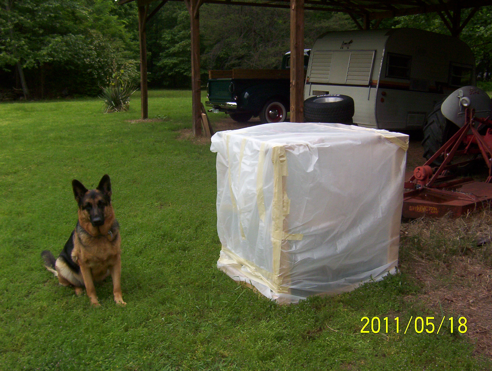

                    Bad news... Just checked out the fumming tent and I see no difference at all. The ammonia must not be strong enough. I've checked all the places that have been suggested but here in the Chattanooga area, which happens to be a big meth lab locale, it's apparently really hard to come by. But, I'll keep looking.
                    Here's Sweet Willy guarding the fumming tent.

                          FWIW, I recently tried fuming some brass hardware to age it slightly. Nothing much happened after 30 minutes.
                          Then I put the coffee can holding the ammonia in a bucket of hot water to warm the solution and the brass darkened Immediately!

                              Reminds me of the chemistry rule of thumb- an increase in temperature of 10 degrees Celsius doubles the reaction rate. It's my favorite way to clean barbecue grills: put in a black plastic bag with 1/4 cup ammonia, and let sit in the sun for a few hours- all the gunk drops off.
                              Maybe you can try fuming using household ammonia with a black plastic tent in the sun.
