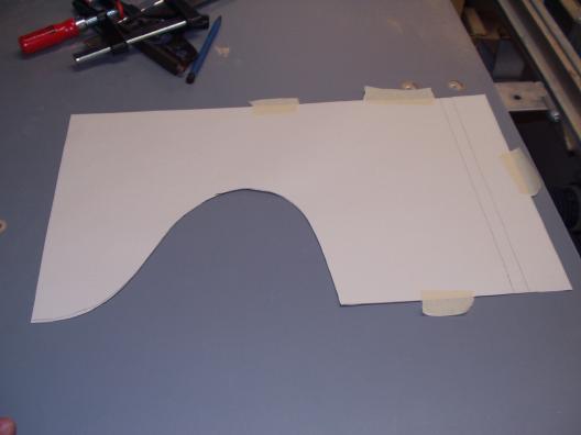

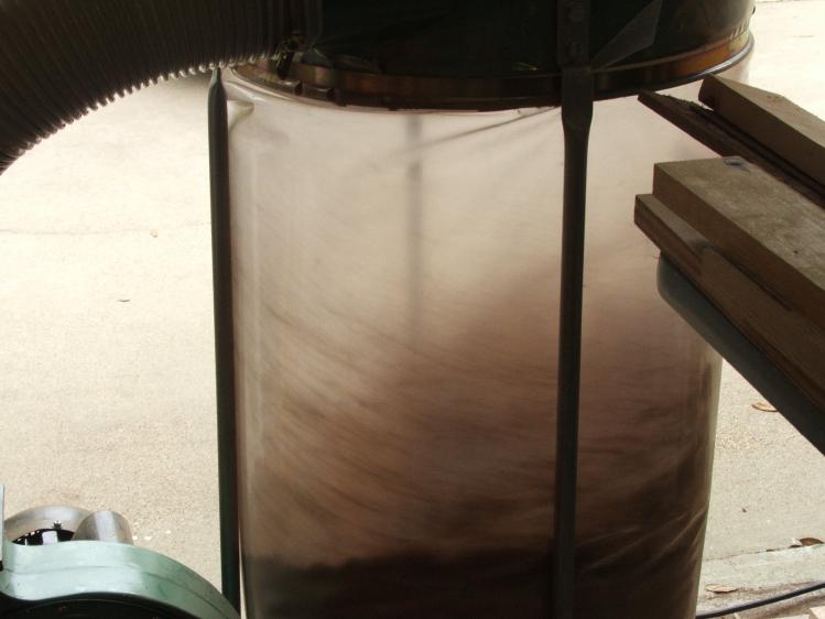

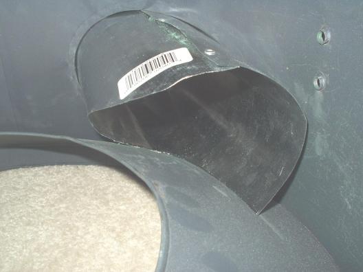

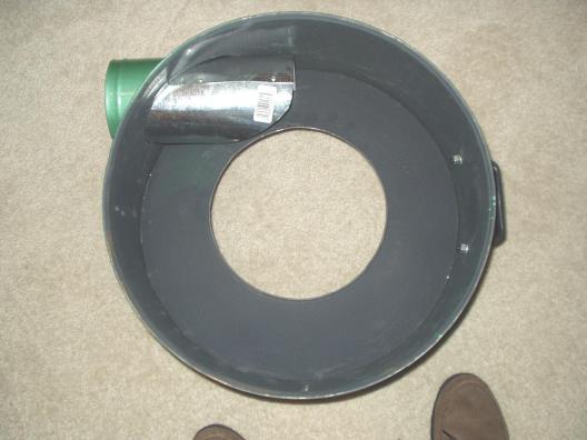

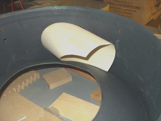

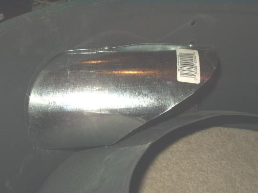

    Some pictures of a neutral vane for the HF DC. Helps direct the air flow into the ring and avoid mixing with the vertical air exiting the lower section. Picture showing swirl helped by NV. Recommended by Bill Pentz.

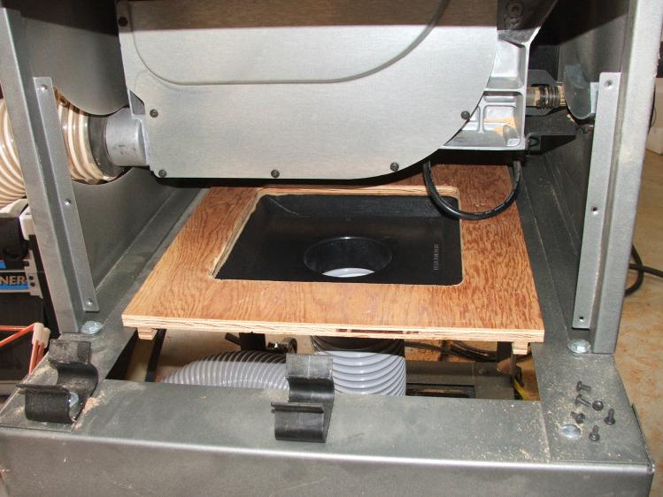

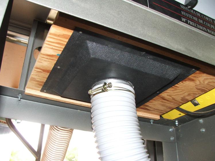

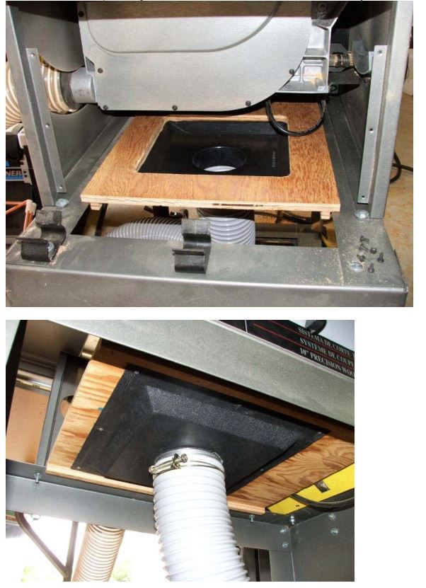

    Simple Belly pan for the BT3 for a DC 4" hose - works great leaves virtually no dust on the inside; helps avaoid shim and elevation and motor problems.
    Picture with side removed shows typical cleanliness when using belly pan and DC.

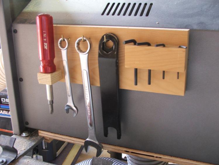

    Magnetically attached BT tool rack = handy for blade wrenches, allen wrenches and screwdrivers

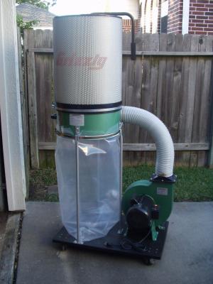

    HF 2HP DC with Grizzly canister mounted. Fits 20" ring perfectly. Note beater bar handle on top, helps clear fine dust from pleats.

    Also poplar was the Bottom DC Dust port I added to the BT3

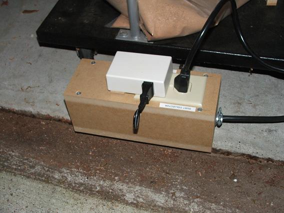

    Relay remote:
    This relay booster allows a inexpensive wireless remote or automatic sensing switch rated for only a few amps to control a DC drawing 15-20 amps and maybe 60-70 amps staring current.
    It also allows running the DC off a separate circuit so that the auto switch doesn't draw both the tool load and the DC load from the same circuit. (and one or the other can be 220V).
    The box houses the relay. THe wire on the right plugs into the wall to power the DC- could plug into 120V or 220V whichever your DC requires. The DC plugs into the top. The plug coming out the front side of the view is the relay control. THe top white box is a wireless remote control.
    Circuit and construction article available by PM request.

      Loring, that looks really good! It seems like your belly pan works better than mine for some reason though. I typically get some build up in the corners of the saw housing with mine, but other than that, it's clean...
