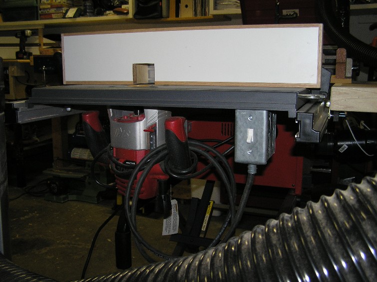

                            Lee - similarly, the reason why I fastened a separate switch to my auxiliary table, as shown in the picture below. Besides being too far away for comfort (read: safety), I didn't want to confuse which tool was actually plugged into the switch.
                            On topic to the thread - no vote, because the few close calls were caught by the pawls. I always use the RK on my 21829 (self fashioned), and always use the guard when ripping.
