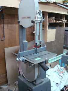

    I'm in need of a bandsaw and found an approx. 10+yr old Delta/Rockwell model 28-200 on CL, asking price of $500. (see attached photo).
    Any thoughts on whether this saw is worth buying (vs spending more to buy a new Jet or Delta), and also a reasonable price for the unit. I see on amazon, what I assume is the now Delta equivalent of this unit (28-206) for ~$600.
    Thanks!
    • 22038
    offhand comments.
    Looks to be in good shape.
    looks to have the riser and a fence which are extra cost items. maybe worth $150 new or more.
    Still a 10 year old saw - commanding a fairly high price.

      I've seen posts of people buying these models used for anywhere from $75-300.
      Does anyone know if parts are readily available for this model?

        Just found out that this unit is even older than originally thought. Built in 1965.
          • 22038
          I was thinking if it had the Rockell name on it it was older than 10 years...
          But the Rockwell built Delta stuff was supposedly well built. The Delta 14-inch bandsaws are like the model that was widely copied and many subsequent Delta models use the basic parts and surprisingly there's lots of other 14" saw's that have same-fit parts.

            Old iron is very sought after by many and those old Delta bandsaw are no exception. However that price tag IMO is way out of line. Think about, that motor could possibly be 45 years old. Check out the price of a new motor, deduct that from his asking price and haggle from there.

                If that saw is indeed 45 years old, you might have trouble in finding any parts for it. I suggest that if you can't haggle the seller WAY down, then save up for a while longer and get yourself a new Jet or Rikon with a new warranty.

                    I'm thinking that $200 is the maximum that I should offer. I found one without riser or fence sold that for $75 in 2006, and one more recently that sold for $200 including riser and fence.
                    Thoughts?

                      iturra design is probably one of the more knowledgeable parties in the US concerning band saws and related topics, especially delta and jet 14" BSs. they don't have a website but they can be reached here:
                      http://www.manta.com/c/mmc3znn/iturra-design
                      their catalogs have a wealth of information and even a comparison test of a delta and a jet 14" BS. not too surprisingly, the delta won. (it's fairly obvious that the WMH tool group that owns the jet an powermatic brands is primarily trading on the past quality of those brands.) contact Lou iturra. buying anything from him gets you one of his catalogs, which is like a textbook on band saws, especially where buying used band saws is concerned. a little research beforehand will help prevent making mistakes like getting a jet or powermatic BS.
                      if i were looking for a BS, I'd look at grizzly and, believe it or not, some of the craftsman units which are rikon clones at sometimes really good prices. grizzly consistently seems to deliver good value with reasonably priced products that actually deliver what others try to deliver. the rikon 10-325 gets very good marks for BS performance, but it's $900. woodcraft usually takes $100 off @ certain times of the year, but that's still $800.
                      if you're budget tops out at $500, there are three grizzlys that can be delivered to your door for around that much. here's one:
                      http://www.grizzly.com/products/14-1...-Series/G0555P
                      if time isn't of the essence, keep checking CL. armed with the information if iturra's catalog (which has a "buying guide" for used BSs), an informed decision is possible.
                        I was also going to comment on the age based on the Rockwell name still on the machine. The Rockwell name disappeared for a number of years and the line was just Delta. The old tools are solid and well made but, as was already mentioned, parts could be a problem. Bearings can be matched and tires should be a common size.
                        Best I would go would be $300.
                        I have the Grizzly G055. It is the same as the G055P except for the color and is one sweet machine. It comes with bearing guides, fence, and miter guage wich are extra on other saws. Also, the riser block kit is about 1/2 the cost of the kits for Delta or Jet.
                          • 9541
                          That seller is way out of line with that price tag... That thing is worth $300.00 max...
