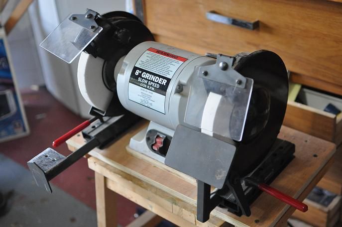

                          So I did get the grinder :
                          As you can see, he'd added a plywood base to it, and also has two adjustable ancillaries in front of either wheel : the tool-rest, and another for a variable angle chisel-rest on the left (can be interchanged). Richard, I think it replicates most of your jig's functionality, and I can do as you did with very little further effort!
                          Not bad for $50!
                          The seller moved recently from Hew Hampshire and wanted to lighten his load; he offered me a 12" miter saw by PorterCable for $150 and a Benchdog router table for $200. But I needed just this...
                          Thanks for all the help, people!

                            Do you KNOW what you snagged? That as you called it, ancillaries, is a Wolverine jig. You got an OBSCENELY great score there!

                              Oh - now that you tell me, so it is (I googled)!
                              Interesting - the seller did not mention it and I did not realize it. I feel I did not give him good vibes as a ww-er : he evidently thought I was clueless about all things ww-ing, he kept asking me "...do you what a router is? have you heard of a miter saw?..."
                              But I guess the score counts more...! I do think the jig is missing the V-rest on the left. I should be able to fabricate something. As it is, my chisels are a tad too long to rest within the arm; I'd need to extend it by a couple of inches.
                              And yes, Rich, I also got to Woodcraft and got that same dresser. Now to check those videos out from Oneway.

                                #30
                                Dude you got a MAJOR score! On second though, for $50 it IS TOTALLY OBSCENE. The Wolverine looks complete for the "standard" jig. You can either fab the skew jig and the vari-grind, although the vair-grind is a bit fussy. The fact that this setup is copied a lot speaks to it's usefulness. I spent probably 2 days doing a shop built equivalent. If it had not been for a great scrap metal place close by it would probably have been cheaper to just but the thing. Enjoy the videos. They have been posted to YouTube but you can download them directly to make it easier to replay.
