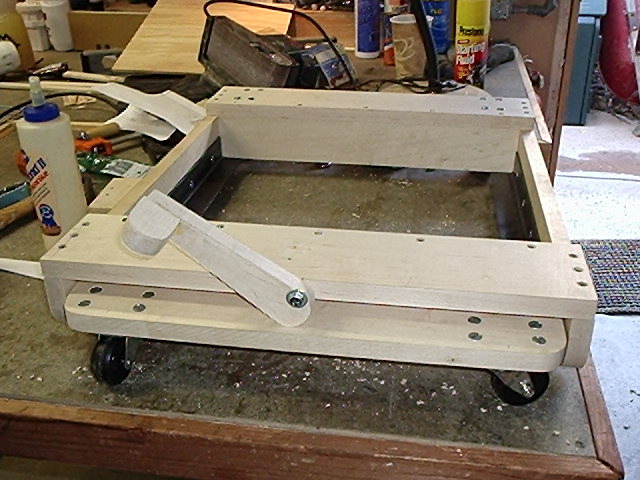

    Another option is a shop made base that was published in Wood magazine several years ago. It was designed with a lift on one end with swivel casters and fixed casters on the other end. Most members that use them have found putting a lift and swivel casters on both ends makes the tools more manuverable. I had trouble with the lever coming loose and modified the lever to a step down design from the original 180 degree rotating lever. If you go to my webshots albums you can see the different designs inf the albums for the lathe cabinet (original design) and the jointer (my modification). This base raised the tool about 1 1/2 - 2 inches.

      I've also done the wood mag design. Pappy and I have both posted multiple times on this topic. I haven't implemented his mod to the lift mechanism, but I can attest to having the problem with the lag bolt coming loose. I think this is the one I made for my bandsaw. I've also made it for my jointer, table saw, and also a version for my assy bench (which was a fail).

          I had the rudder style base before and then went to a metal HTC base like the HF where the wheels are on the outside. The rudder design is better if you have a stand with open legs. The outboard wheels only swivel in the front and take up more space. I don't like my HTC base and plan on going back to the rudder style/foot operated lift.

            I've done the rudder style and am disappointed with the lag bolt getting loose. Plus, it's a cabinet I keep my routers and sanders, so the weight may be an issue. I was actually thinking of converting it the othe HF style. I want a stable cabinet that I can easily move to put away.

                The prototype for the lever mod was made of MDF to bolt to my BT3000. The wife, even with bad back problems, had no problem setting it on the casters. With the jointer I have to lift on the ends of the feed tables. But, I am moving over 200#'s of cast iron!
