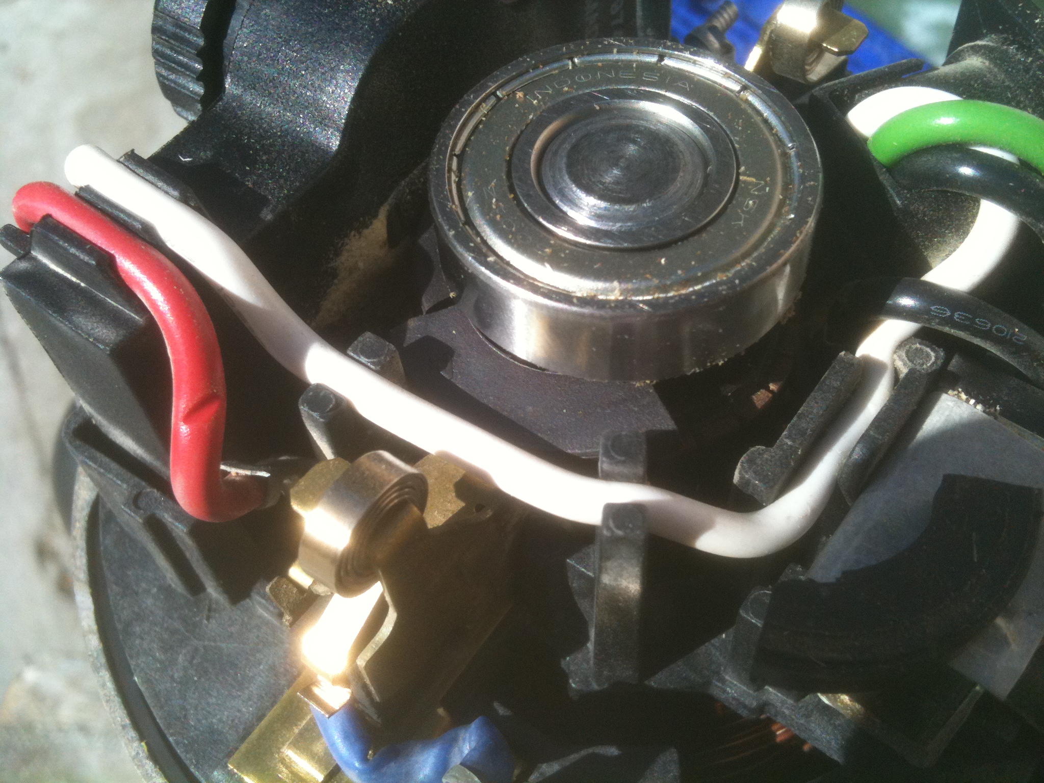

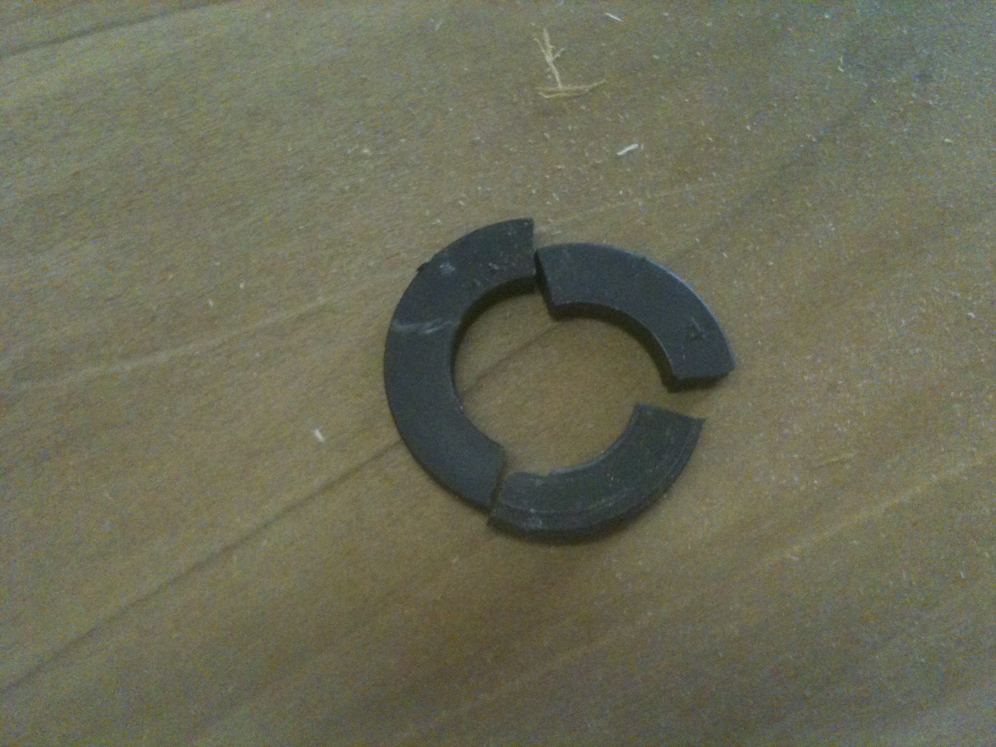

    Using my DW618 today on high but not max speed when I heard a popping sound. All of a sudden router goes to max speed and variable speed knob doesn't work. Took it apart and found magnetic ring broken. See pic and link.
    So do all I have to do is replace the ring?
    How do I safely remove the guide bearing above it to replace the ring? I don't want to force it and break something else.

    are you saying the magnetic ring (below the bearing) broke when you disassembled it or was it broken before you disassembled it?
    If it broke when you disassembled it there are now two things wrong with your router.
    I am not sure what function the magnetic disk has, possibly its part of the speed control but i somehow doubt it.
    If it was running and something popped and the speed ran away to max them it sounds like something electronic gave up the ghost.
    Bearings are generally press fit onto the shaft they support.

      Just re-read my post and see it was misleading so I edited it. I meant to say it was broken before I disassembled.

        Yeah, Ok then the ring could be part of a magnetic speed sensor which would make sense if the ring broke the cotroller would make the motor would run max speed since it thinks its turning too slow.
        This thread seems to confirm it - same router, several had the problem.
        http://www.forums.woodnet.net/ubbthr...llapsed&sb=5&o=
