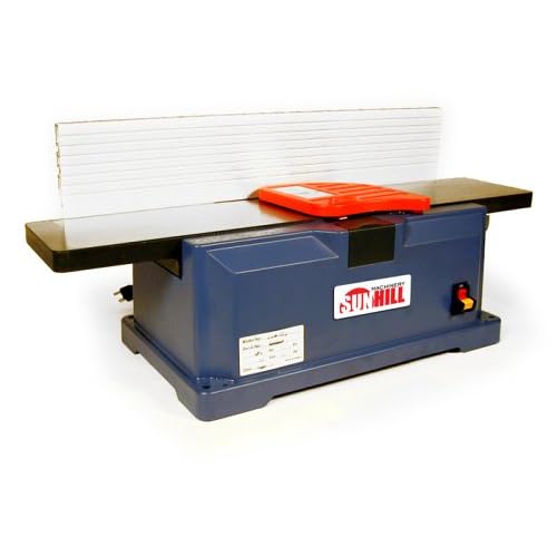

          I have the same Sunhill bench top jointer (SM-150B) and a Ryobi AP1301 13" benchtop jointer. The Ryobi jointer is still commonly available at Home Depot for $229.00 and is a decent machine. The New Lower Price claim on the Home Depot website is a fraud though. Less than a month ago it sold for $199.00 on the site and in store...
          The Sunhill Jointer was simply a Geetech 6" jointer with a different sticker applied to it. Woodworker Supply sells them for $139.00.

                  Take a look at Sunhill's website. No more SM-150B. They have the SM-150 which is the long bed floor model, a bunch more money, and a TON more floor space consumed, which at least in my case isn't a good option...
                  As far as the Sunhill and Geetech being the same unit, just look at the pics...
