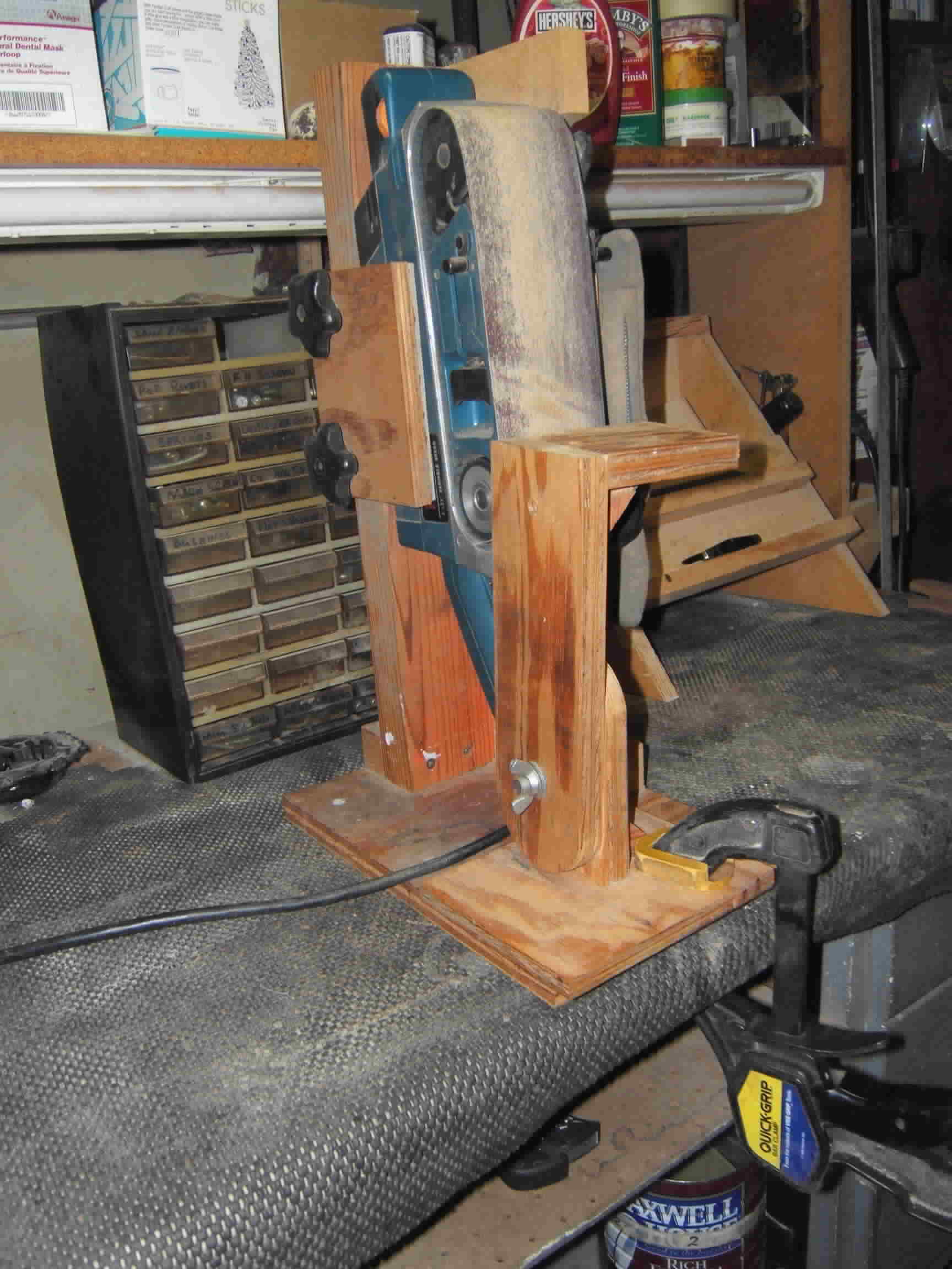

                        Here are a couple of pics of the fixture I made for my Ryobi 3X21 belt sander.I've used it for several years, and there's never been a problem with the sander coming loose.
                        I keep the sander switch locked in the "on" position, and turn it on and off with a switched outlet (seen below the clamp)
                        Off subject, but I also used a switched outlet on my miter saw, both the saw and the shop vac (with its switch in the "on" position) being plugged into the outlets. Flipping the switch on the outlet turns the shop vac on and provides power to the saw.

                          Thanks, can you post some closeups of the clamping. I can't quite see what holds it in place. Exactly what I had in mind BTW, especially the fence.

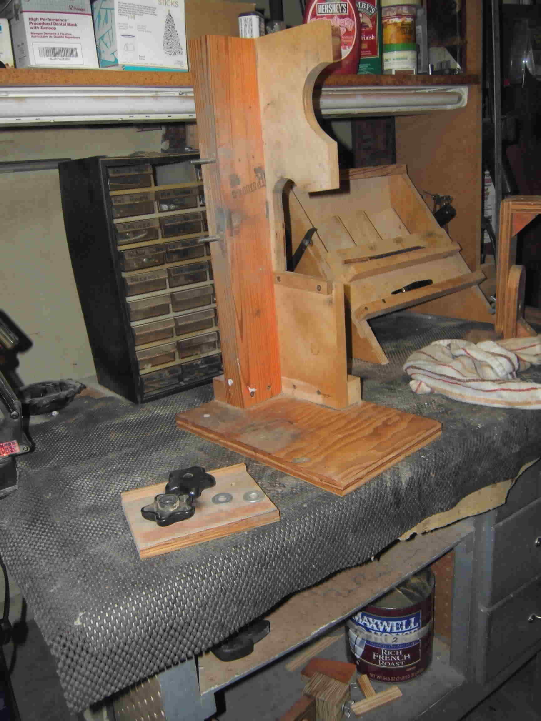

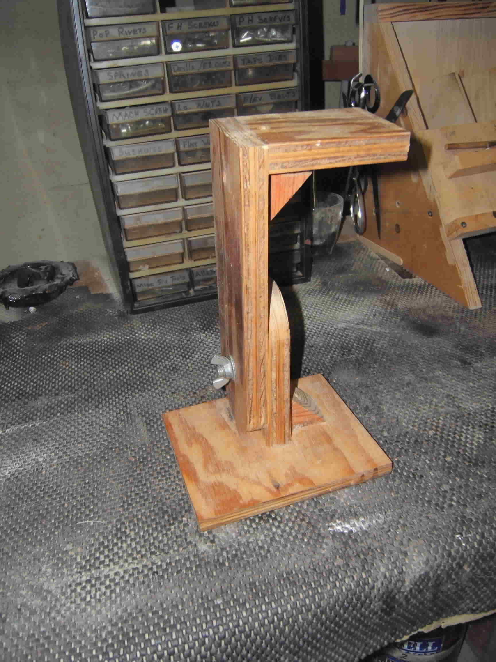

                            Bill,
                            Here's the fixture disassembled. The clamp is a piece of 5//8" plywood with holes on the back edge to match the 1/4" bolts epoxied into the back (vertical) piece.
                            I glued a piece of 1/4"thick felt along the front of the clamp where it meets the sander. I made the back piece about 1/8" more narrow than the width of the sander to insure firm clamping.
                            The sander is supported by the clamp, the back piece, and the side piece (with openings as necessary to clear protrusions on the sander).
