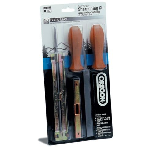

    I use a hand kit similar to this. I'm thinking it's easier to buy a new chain than to sharpen. Is there a better (faster or more accurate) way than this kit. I've seen the powered units. Any suggestions?

      I am not an expert on chain saw sharpness but I have used the Harbor Freight unit that sells for as little as $30 and ended up with blades that do a good job of cutting. After spending a little learning how to use it, I can sharpen a 16" blade in a short time (maybe 10 minutes).

          Cabinetman,
          I use the arrangement you illustrate and I am very happy with it. I usually just sit down and sharpen the chain rather than change it out since it takes me a similar amount of time. I loaned my saw to a friend of my son's and he had the chain "professionally" sharpened prior to returning it. While that was polite, my sharpened chain will cut better and longer than the "professional" job Kelly paid for. I find that if I sharpen as soon as it fails to throw shavings - starts to look more like dust - it takes only a few strokes per cutter and not a lot of time. My saw only has a 14 inch bar, however, so that is part of the reason it does not take real long.
          My other clue that the chain needs sharpened is when I do not need to lift up on the saw to keep it from bogging down. If I find myself feeling like I need to push down or rock the saw around, it is time to stop and give the chain a few strokes with the file.

            I've used the kit shown, a Dremel adapter, and even bought this at Harbor Freight when they had a 19.99 coupon.
            http://www.harborfreight.com/cpi/cta...emnumber=93213
            I have 3 chains each for both of my saws and have them done professionally and swap them out. Between the Dremel, the HF grinder and the hand file, the hand file is the best option in my opinion.

              I tried the Dremel, and threw it away after one use. The stones don't last, and it's only as accurate as the steadiness of your hand. I now use the HF sharpener. Only thing to be careful of is to set it up carefully so that you don't take too much off during the sharpening operation. This thing has paid for itself many times over.

                  Do you use a kit or some guide jig for the angle?
                  I have, and I believe that made for a better edge than freehand. I just think that I'm impatient, and end up with a sloppy job.

                    I don't use mine that much anymore either, but I use basic version of the "deluxe" version in link from the OP. I usually pull it out when the cut starts to "curve". So I know the problem I'm looking for as far as remedial sharpening goes. I usually just sharpen the teeth on the indicated side first, then the other, if necessary, the other

                      The first time I needed a sharpening I had a shop do it. Like you, it didn't seem to last too long. I think the angle used might have been to great, creating too thin of an edge. The second time I used the guide I noticed the suggested angle was less than the one the shop provided. I think it turned out sharper, and lasted longer.

                        [QUOTE= I'm thinking it's easier to buy a new chain than to sharpen.
                        Buying is definitely easier but changing every time you need to is way more labor intensive than a few strokes with the file. I don't remember what brand sharpener I had but it took a while to get the procedure down. It came with a guide but eventually I could do a good, fast job with just the file. It only takes 2-3 strokes per tooth. It helps if you have a way to hold the saw in position while you sharpen. Also a good after market blade may reduce the number of sharpenings needed. If you are in a wooded area the time required for resharpening is also therapeutic, a few moments of rest and relative silence, an opportunity to commune with nature.

                              Sharpening a chain like most things takes some skill and experience, something I never fully acquired. You don't really need to either. You just need enough skill to put the edge back on while you are using the saw. Then you take it in and have someone who knows what they are doing sharpen it properly. You do have to watch that they do it right and not in a way that insures a quick return for another sharpening.
                              The hand file with the guide is perhaps the best. It's really hard to totally destroy the chain with it. The power grinders like the HF one on the other hand can turn the chain into a prop for a slasher movie faster than you can drink the beer you are having while working the tool.
                              If you do go the route of the HF tool you should practice on the neighbors chain saws prior to tackling your own. This should help to keep Saturday Mornings peaceful while the neighbor is down at the power equipment shop getting his saw fixed.
                              BTW, most problems cutting with a chainsaw start with not enough oil on the bar. Auto oilers need an extra pump when the going gets tough.
