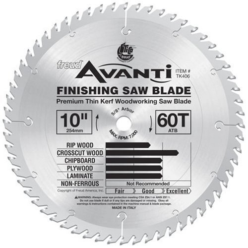

                      Hi Sarge - I can't help but wonder if one of the owners was wrong about which model they had. 15° is fairly easily recognized as a steep hook....like that of the Freud LU88, Diablo 1060, and the Freud Avanti TK406, which are better suited for TS. Or maybe Freud has changed the geometry over the years...?
                      Here's the TK806 from Rockler:
                      Here's the TK406 (60T w/15° hook) shown on Amazon:

                          I can tell you it is NOT a 15 degree hook angle. My father had picked one up from Lowe's on clearance (was more then Rockler), and Sunday I picked up another LU85R010 ($36 gloat). I took it over there as he knew I used a different blade, and he wanted to learn the differences. The LU clearly had a steeper hook angle, and it is 10 degrees, so I am pretty sure the TK806 is 5 degrees.
                          Unfortunately, trying to explain some of the differences, and how you can tell one Freud blade from another, isn't exactly easy when your comparing it to a discontinued line, that isn't even on their website.
                            From the pics Scott posted (thanks for the assist Scott) I can also tell you it ain't 15 degrees if that 60 T is. I tend to agree around +5 degrees positive comparing pictures which should be fine in the slider. I went to the web-site earlier today to try to confirm the angle LR but.. as you state there is no info available at this point due to the dis-continuane.
