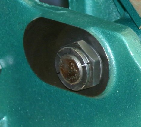

You are correct in that the bearing arm [20] is mounted into the trunnion by the pivot shaft [40] which is secured by the large hex nut [42]. On my saw (IRRC) there was also a set screw (or bolt) that fixed the bearing arm to the pivot shaft so that the shaft actually turns in the trunnion. Once you remove the nut and loosen the set screw, the pivot shaft should drive out through the opposite side of the trunnion. One thing that confused me was your remark about the "two halves". If by that you mean the center trunnion [9] as one half and the bearing arm [20] as the second half, then we are on the same page.

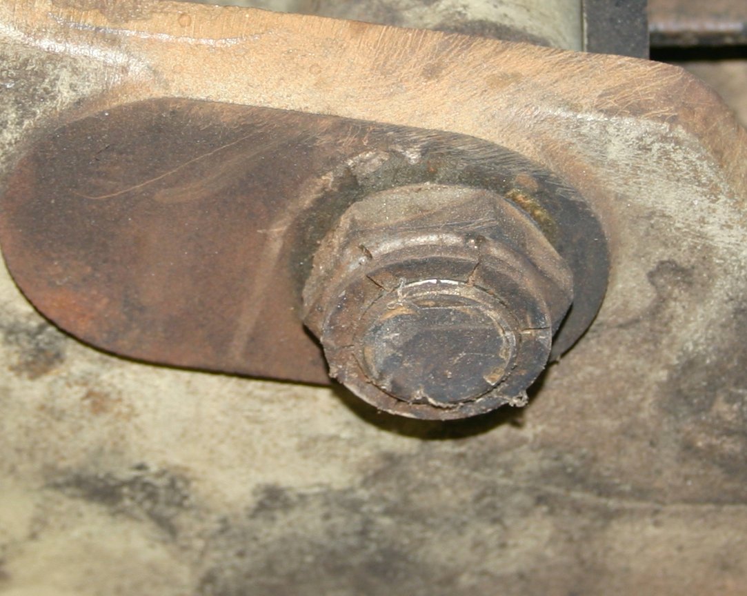

Regarding the raising shaft, I removed the gear segment [20] (held on by two cap screws) and then the collar. Once that was done you just drive the shaft out through the rear of the trunnion, although I don't think the removal is required. Photo below is from the bottom of the trunnion after the gear segment was removed. (The large hex nut is on the left side of this shot.) As you can see things were pretty grotty. I cleaned the grime off with Super Clean, wire brushed/Evaporust-ed away the rust and repainted.

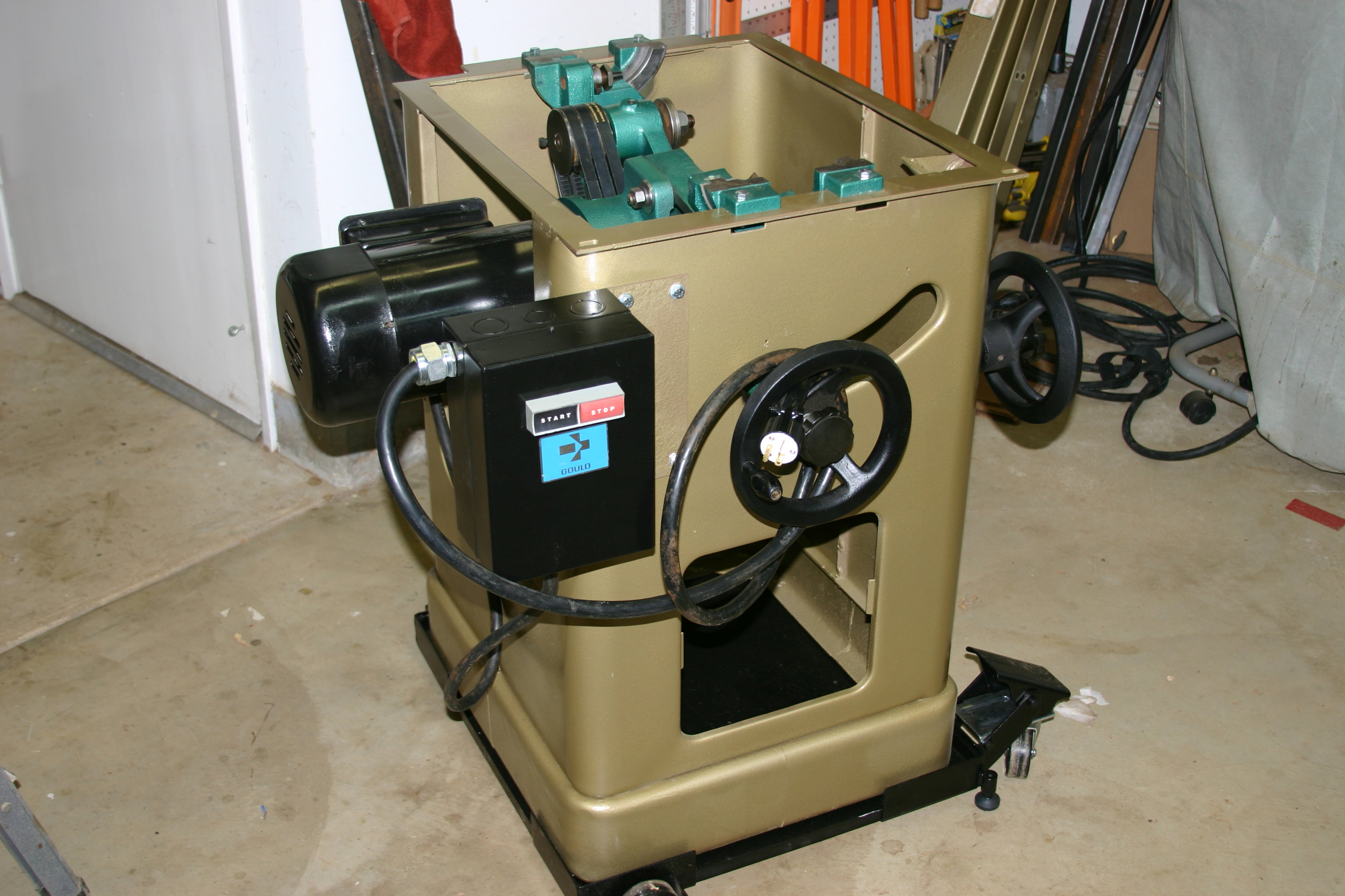

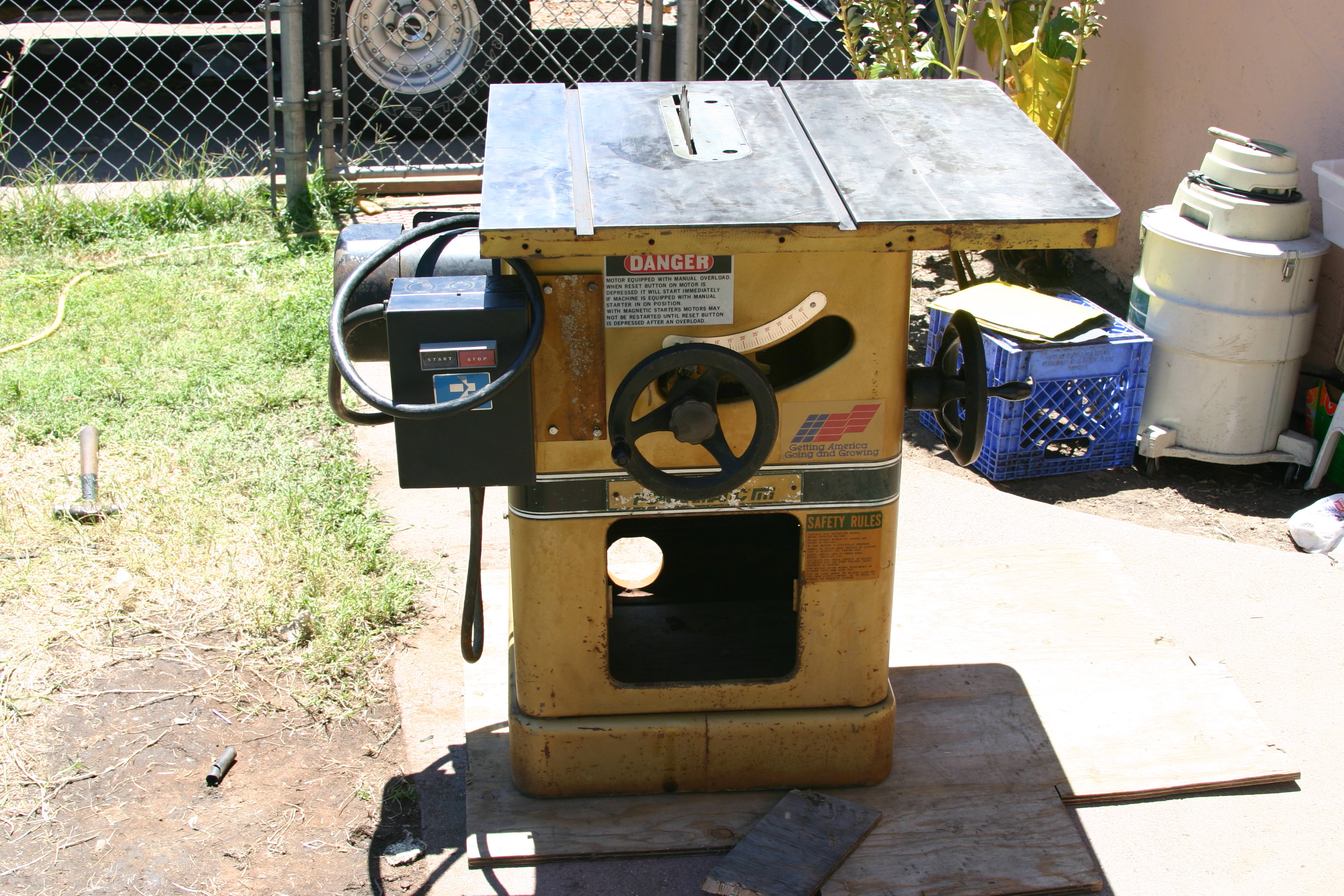

As regards painting, since everything needed it (see last photo) and I had no intention of trying to do a factory match, I used the green rattle can for the trunnion and the sprayed the gold Hammered. I figured it's my saw, I can paint it however I want!
