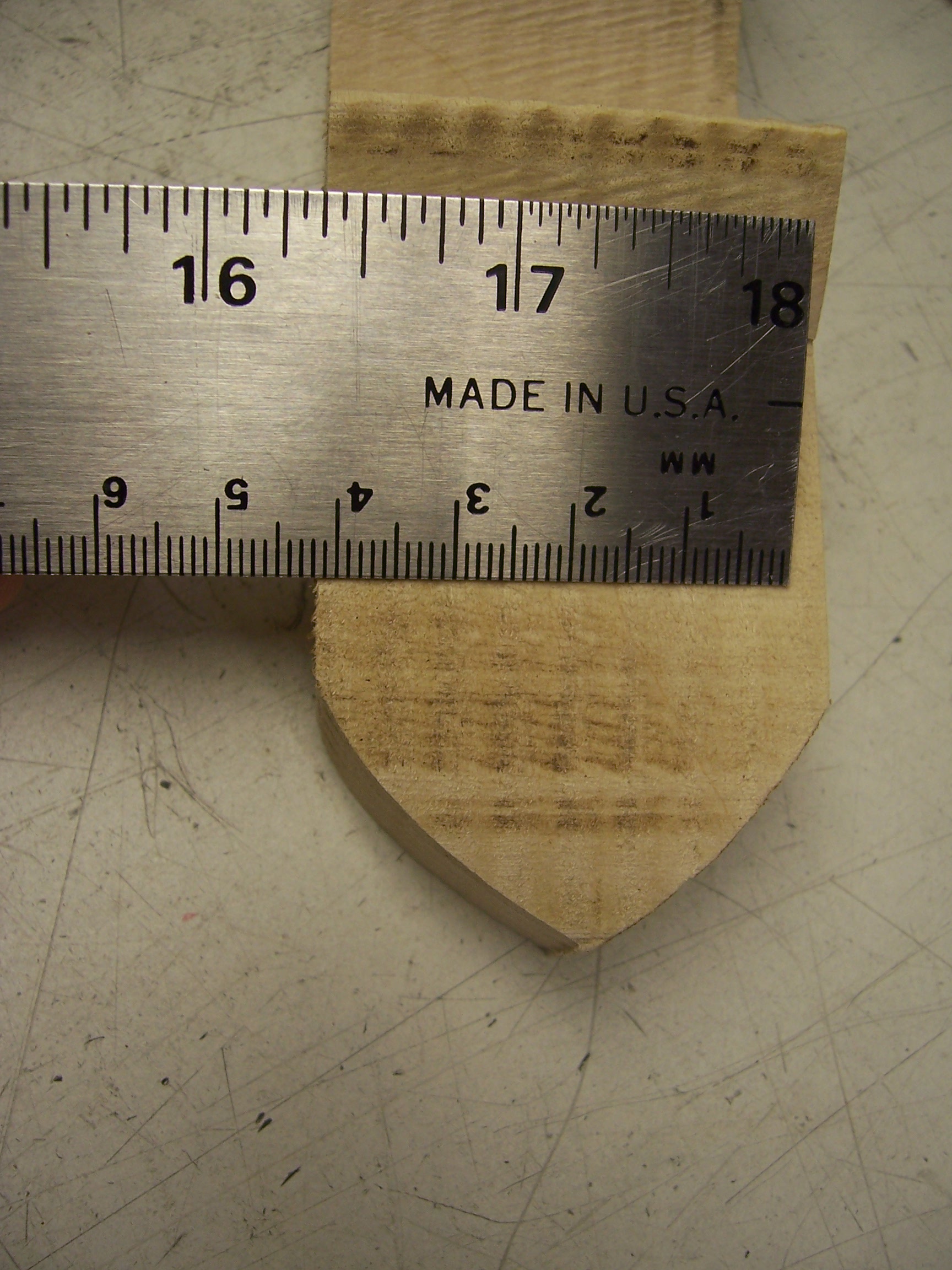

    I just started using my bandsaw (Sears 21400 10" rebadged Rikon bought on CL) and have been seeing these odd ripples in the cuts I have been making. Unfortunately I was under the gun to get a Pinewood car done on time, so I was forced to buy a Craftsman blade (no time for a Timberwolf, etc. to be shipped), but I did tune it up per the Woodscrub blog directions others here have recommended.
    The symptoms are that I find the blade to go through rather slowly (not "like butter" as I have heard others comment should occur with a properly tuned bandsaw). Additionally, when I look at the finished cut, I see a defined ripple in it. This ripple effect has a definite period to it (distance between peaks and troughs are consistent), and is not just visual; you can feel a distinctive ripple in the wood that must be sanded out. I have attached a picture for reference.
    Does this sound normal? Any clues as to what might be causing this (cheap blade, user or setup error, etc.)?

    • 22055
    probably an incorrect blade tension issue.

      And possibly a dull blade as well, How much time on the blade?

          LChien - I considered that, but tried to set up the blade as close as possible to the blog instructions people recommended.
          Tommy - the blade I am using is brand new. Not the highest rated brand (Craftsman), but it was new out of the box.
          Mr_Bill - I think you may have hit it. Looking at my saw, the blade has one part of the tooth at 90 degrees to the movement of the blade and another at an angle. The way the blade is set up now, the part of the tooth that is perpendicular to the blade movement hits the material first. This seems wrong to me - I think the angled side of the tooth should go into the material first. Can someone confim the correct way the blade should be oriented (sorry for such a basic question).

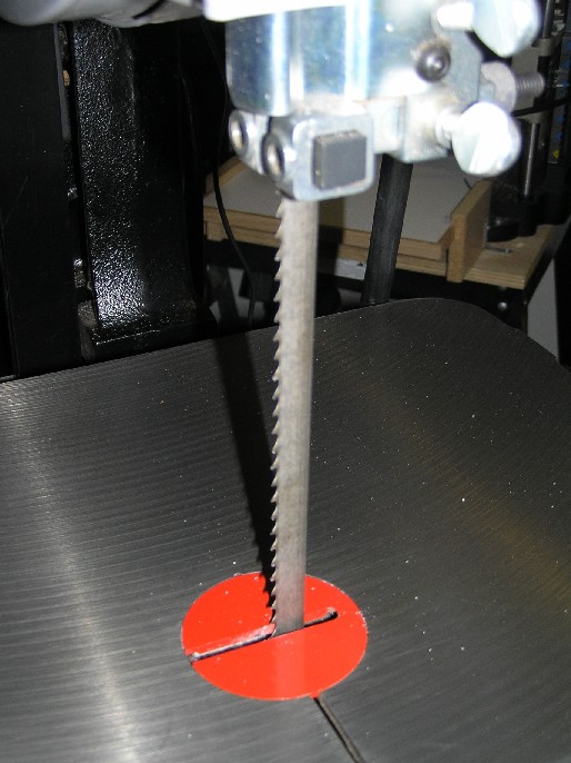

              No it sounds like you have the blade on the correct way.
              the 90 degree edge does the shaving of the wood.
              since the front of the blade goes downwards, the hook of the blade should look like someones nose.
              If the tension may be incorrect, try some other tensions higher or lower than what you get "by the book" - experiment.
              here's a pic of the correct tooth orientation (the teeth travel down in this pic):
                Pete,
                Not sure what kind of blade you're using - but there's a fair amount of things to check, including blade orientation, sharpness, tension, tracking, guides, etc. For your question on blade orientation, I've attached a pic.
