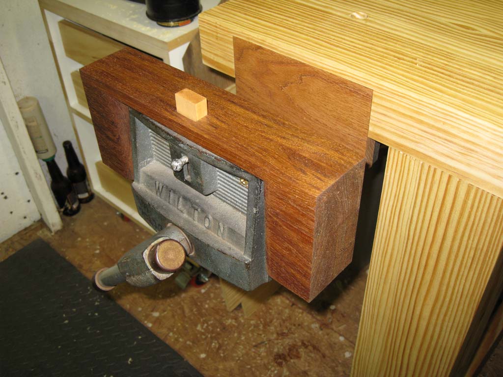

        I've got a pair of old Wiltons on my bench, but they're different models. What happens when you go to close the jaws, does the back of the handle casting close the gap? If so, I'm thinking there is something missing at the jaw and the threaded rod that holds it in place.
        This is the best photo of mine that I have here at work.
