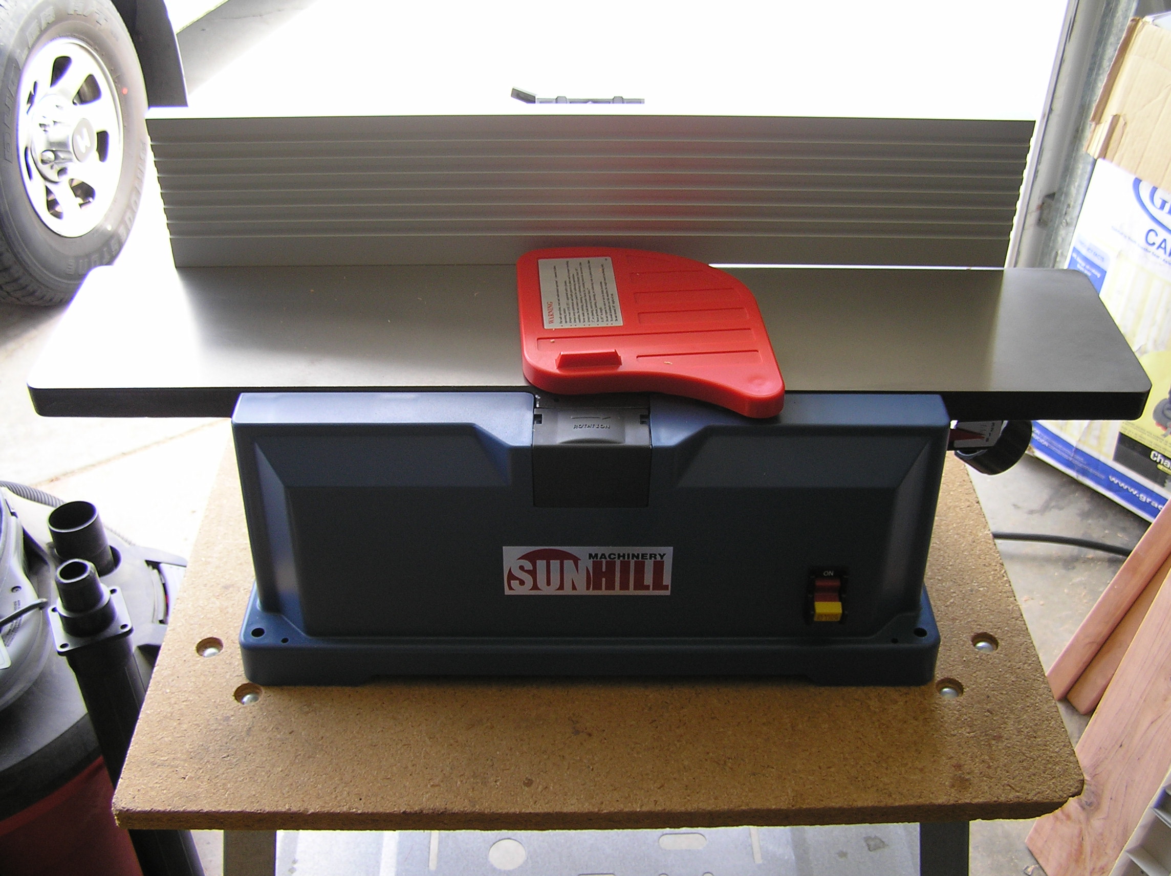

        I have no experience with the Grizzly model, but it is reminiscent of similar models owned by others here, like the SM-150B I got from Sunhill. Should be a good unit - if you get it, post a review on it.
          • 9568
          I too have a Sunhill SM-150B, and am very pleased with its performance. However finding one new is going to be a challenge as it appears Sunhill stopped selling them this year...
          From what I can tell, there are FAR fewer bench top jointer options today than there were two years ago. Which is a pity...
          I would suggest calling Sunhill Machinery at 1-800-929-4321 and asking them about the SM-150B... They may have a few still knocking around a warehouse somewhere...
          If I had a choice of what I see on the market now, I would pick the Grizzly.. I am not real impressed with the build quality of the JT160
