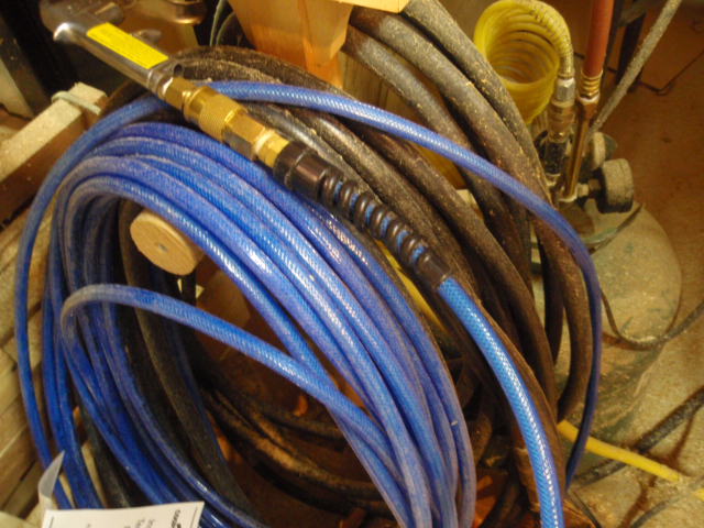

                Polyurethane hose: extremely flexible, 50-foot only weighs 3 pounds, about a third the weight of Rubber hoses. I used to swear by rubber over PVC, but this stuff is nice. not the cheapest, but a real pleasure to use. The wall is much, much thinner than rubber or PVC. Two things to think about - at 1/4" ID it'll drop pressure more at higher flow rates than 3/8" rubber, but for nailers and stuff, its no problem. It also resists twist somewhat - so if you pull it off a coil lying on the ground it'll follow you like a coiled spring. When you untwist it, then it'll lie straight and flat and limber with virtually no memory. When you need to coil it up again to hang it on a peg, you'll need to twist it once for every coil. Another good thing about PU is that it's skin is slick, it doesn't grab like rubber, so its easier to pull around. As you can see by the pic, it so slick sawdust doesn't stick to it.
                http://www.amazon.com/Air-PUR-14X050...5759541&sr=8-4
                There are other manufacturers, I got mine from amazon 3 or 4 years ago. Something to aspire to, anyway. Maybe a hint to santa...
                if you go to search and do a seach (on BT3Ctrl) for polyurethane air hose then you will get some useful threads. Some of the threads say Costco has had PU hoses for $13 (50' x 1/4"). I see 1/4" for sale in many places but do not generally see 3/8"... I'd say for heavy duty use with lots of foot traffic and high air flow rates (like a commercial auto repair garage) stick to rubber but for personal shop use where lightness and flexibility count, PU is the way to go.
                The two attached pics show my PU air hose rolled over the 3/8" Goodyear hose; the second shows how flexible it is.
                    Thanks for the info on the poly, I'll have to look for it the next time I am at COSTCO. Looks like it would work on a real rather well.
