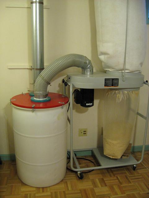

                              The 50-760 is a very nice unit.Here is another installation idea. I flip the motor upside down for easier hookup of the 5" metal duckwork and the 55 gallon separator. The top mount ductwork makes it easier for adjustment. BTW, the 30 gallon drum may be a little too small for this unit IMHO
                              Howie
