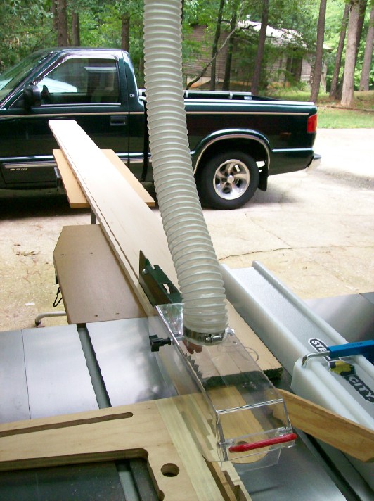

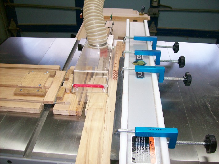

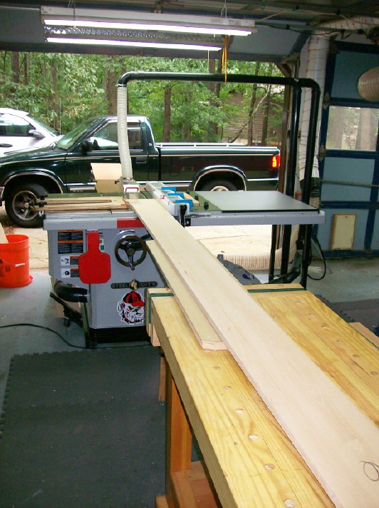

      I've got 5 of the Ridgid flip top stands Carlos. One is used as a 3 foot rear extention on the back of my Uni-saw when I had it and now my Steel City 5 HP. Another has a built on board to extend farther out when I open the garage door as you do. I rip for hire and 10'-14' is standard fare when I do a job for someone.
      Thats requires proper support front and rear. In front of my TS is my work-bench whic is 3/4" lower than table top with a Veritas twin screw vise on that end. But.. if you lay a piece of 3/4" MDF down on top of it with a vertical piece dadoed in that clamps in the vise below you have a match from WB to TS top.. and my asembly table sits behind the WV in a straigth line so I have another 6' support in front. I can line up Ridgid flip tops outside to compensate for whatever lenght.
      Good luch and BTW.. one h*ll of a nice job on the Uni-saw. I prefer my switch left of blade below the rail so I can kill the TS with my knee as I don't like to lean across. When I want it off... I just want it Now!

          Sarge, that is a great setup. Looks like you can back your truck in to receive the cut wood and send it on its way.

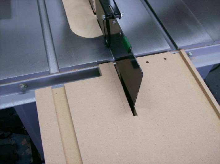

                I prefer friction surfaces on my extentions in lieu of roller or ball bearing. I had a 12' slide on a roller bearing and cause some trouble meaning major kick-back. Saved by the feather-board left.. crown on top and fence right. Maybe not as much of a problem with short stock but I swithced to friction support as the Ridgid has soon after.
                I don't need long stock being assisted to move out of position as I equate the rollers and ball bearing support to a greased pig attempting to sit on top of a flag-pole ball. Again.. standard stock might not present the same problem as it is easier to control so.... my situation might be considered a minority one.
