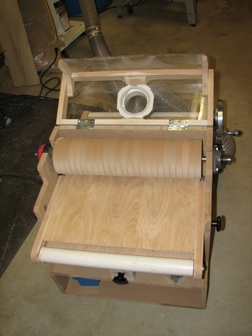

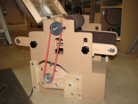

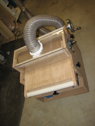

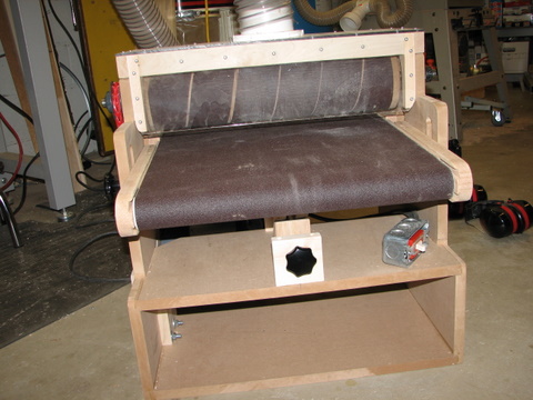

                    I actually just finished putting mine together this morning...
                    Like many, it is based on the shopnotes plan, but with a bunch of modifications to use parts I could scrounge up (flange bearings, C Frame Motor, etc.) and to include it's own motor rather than mounting on the tablesaw. I also made it a little wider and the platten a little longer than the plan called out. I kept it small overall so it could be set up on a bench because I just don't have a lot of room in my shop. The pictures tell the story, let me know if you have any questions!
