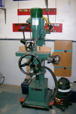

              I don't have a DP drill press attachment but have used several. I did have a bench-top for several years and now have a 650 lb. industrial floor mortiser with a stroke of luck. I also hand cut mortises for years before the bench-top as I use M & T's weekly and it is probably my most used joint. I even do face frames with them.
              But.. even though I didn't vote.... I will state why I would not purchase one personally based on the one's I have used:
              1... Mortising soft-wood and hard-wood are like comparing a domestic tiger to one in the wild. More force is required to plunge the chisel in hardwood and that's a fact even though the chisel should be removing the main waste before the chisel takes the sides.
              2... More pressure requires better leverage. Compare a mortise machine column and gears to a DP. Again... apples and oranges. The MM has a very sturdy column... strong gears that are made to take pressure and a long handle to increase leverage.
              A DP is a "finesse" machine which is engineered to deliver a small drill bit tip to start a hole and then an engineered twist to complete the task. Very little pressure is required really.
              3... When you take # 2 into account... forcing a chisel 1/2"-3" deep into hard maple.. oak.. etc.. etc.. is putting a strain on the light gears on a DP as it was engineered to do a rather light task and that is drilling holes. Bad medicine for the DP gears that will lead to wear and excessive run-out IMO.
              4... Hold-downs are critical in hard-wood. If you have ever got a chisel stuck in hard-wood or any wood it is a PITA. Even bench-tops come up short here as most have an over-head clamp that allows you to with-draw (which a DP doesn't) but they have no means of exerting any real pressure to keep the stock from creeping on the fence. You generally have to modify and come up with something on a bench-top... I suppose you could on a DP also?
              5... I do mortises often.. I use the DP often especially with forstner bits. I don't have the time to switch as often as I use both from a time or PITA stand-point.
              So... those are the reasons I wouldn't purchase one. If you mainly use soft-wood and don't do many MT's it would be worth consideration. But... I feel the fact that a DP is a "finesse" machine is enough reason I won't subject my DP to do task it really wasn't designed to do.
              With that said... I have a friend named Ray Pine who is a professional restorer and furniture builder ( a poster boy for FWW mag in the early days) up in Virginia who has one and has had for years. He swears by his even though he does admit to using very light plunge-withdraw-plunge-withdraw method as he is aware of what over exerting on DP gears can do.
              Go figure...
