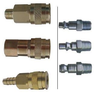

                        The compressor comes with a female coupler already attached, and a PVC hose with I guess one male and one female end. Are these standard size or do I need to match them up with anything I buy?
                        That chuck/gauge combo looks like a great setup. I guess it needs a male coupler screwed in to fit my hose?
                        Another item I'll be tempted by when it's on sale again is the HF plastic welder. Could be useful with repairing/"improving" all the plastic toys round our house.
                          • 22106
                          thisis the chuck/gauge #92360
                          http://www.harborfreight.com/cpi/cta...emnumber=92360
                          male QC couplers are called Studs. 97 cents at Lowes or HD, you'l want the orange ones (There's two or three incompatible types that ulook very much similar). The most common Automotive ones are tagged orange.
                          I keep a few studs with 1/4 male and 1/4 female threads in my parts drawers and a couple of female QDs in case a friendly tool or hose shows up that needs one. They're cheap.
                            Depending where you shop. air fittings (couplers) may not be color coded. The obvious differences is the length and design of the actual coupler end. In the picture below, on the right, the two main types are the short end (top one), and longer one (second one down). The short end is the most common used in shops.
