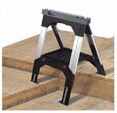

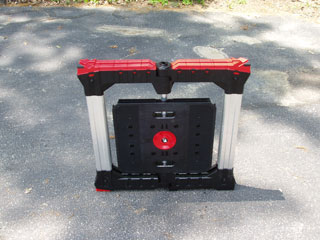

              I have a few Stanley Fat Max horses (aluminum frames) and have found them very useful and stable for a folding horse. Lowes usually has them, and although they are a little pricey, usually puts them on sale at least once or twice a year. I have not regretted the purchase even once. I have fashioned a variety of head pieces for various tasks, including two with omnidirectional ball-style rollers for outfeed use.
                        Ditto here on the Fat Max horses. Out in the field I put a couple of 8' 2x4 studs in the notches on top & throw on a sheet of plywood & have a work bench that is as sturdy as almost anything in the shop.

                        UC...I'd like to see some of those head pcs you've made for these.

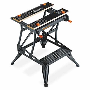

                              Yeah, the other option was to grab a couple of the Workmates if they go high enough and just use the top surface of those... I thought about that.
