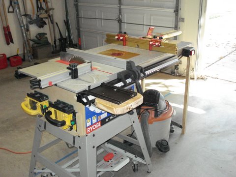

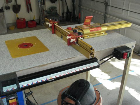

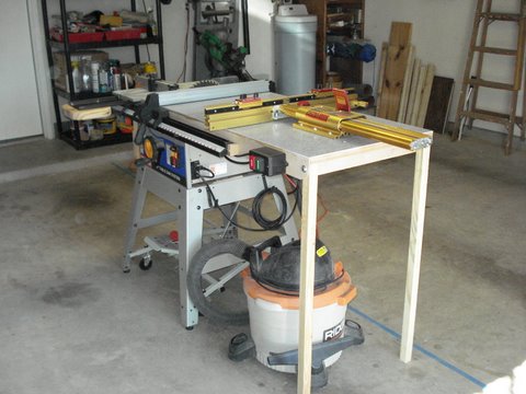

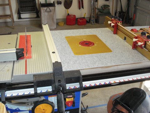

                    Well, I don't know if this is what you are looking for but I thought I would show you what I have done with my setup. I am using a Incra LS17 with my saw and it works quite well for me - YMMV.
                    The table extension is made from MDF and the top is Vinyl tile that I got from the Borg. Although the top is softer than I wanted - it is working out well. I don't know how long it will hold up - only time will tell. If the top wears out sooner than later - they are cheap to replace.
                    I don't use the Incra as a saw fence - I think it would work OK - I just use the original rip fence that came with the saw.
                      That is one magnificent set-up. I am envious and much better functionality on the extension on the BT3100 than on my stand alone router table. Kudos to you for such a great way to do it.
