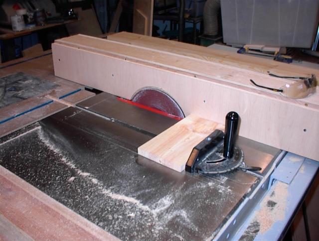

    Ridgid makes a 10" sanding wheel with 5/8" arbor that is available from Toolsnow.com (formerly known as the Cummins Tool truck sales) here. For around $10, if the truck sale is in your area - slightly higher if you order online due to shipping, a table saw and a piece of scrap plywood for a sacrificial fence and you can be in business with a 10" disc sander.
    For setting up the saw, it also gives a flat surface for checking square. (Removing the sandpaper disc is recommended).
    Here is the setup that I use when sanding finished door edges to remove any left-over saw blade marks.
Name:	Sanding Disc setup.jpg
    In place of the fence jig that is shown above, I now use a piece of 1/2" BB ply and a couple of these clamps from Rockler for the sacrificial fence. Makes for an easy-on, easy-off setup.
