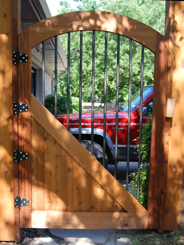

                      I've got the 1617 and it's been a real joy. Here's my first "big" project with it and the BT3K in tandem. Tried loose tenon jointery on this Western Red Cedar & Gorilla Glue gate last year. Borrowed a friend's shop to true one face and planed the stock to get the "hair" off and a consistent thickness, then came home to rip, glue-up, and do some serious plunge cuts. The bars are 1/2" black iron with the paint removed for rusted patina, and set in silicone. (Man, I had some headaches figuring the hole depth in the curved top stock, even when it was still a square glue-up!) Due to the tongue & groove panel at the bottom needing "give" in the weathering, the glue-up and assembly clamping was a one-shot affair, and I was s-l-o-w. Think I invented some new curse words and decided this kind of thing will be a lot easier when I don't have to make do on saw-horses and plywood work surfaces! But thanks to ever-expanding Gorilla Glue, it came out true and square, and after a year of Texas sun and frog-strangler rainstorms is still closing with a finger-touch. The wife is happy, so I am ready to move on to burl-front empire cabinetry! LMAO.
