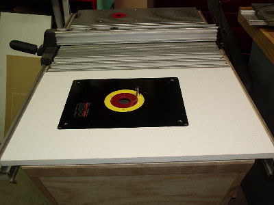

          It seems to be the same quality as pricier phenolic plates. Here's what it looks like installed.

            JR,how do You like it? How hard was it to install? (details please)
              Well, I just got it in there yesterday, WOODOG, so I haven't used it yet. I'm planning to build a new fence next, so I'll give a review after I get that going.
              To install you need a plunge router and a 1/2" pattern bit (top bearing straight bit). I won't bore you with the failed attempts to get it right. Ideally the height of the cutter on the pattern bit should be 1/2", no more than 3/4"
              Place the plate in position. Make a pattern by surrounding the plate with 4 pieces of scrap wood. Use carpet tape to hold the scrap wood in place. Remove the plate.
              Place the plate on top of the scrap wood pattern with the edge of one side aligned with the outside edge of the pattern wood. Put your plunge router on top of this stack. Plunge the router bit to the table surface and you've now set the depth to be equal to the thickness of the plate. Increase the plunge depth by 1/32" to 1/16" so the plate will settle below the plane of the table. You'll use level screws to bring it back to the proper plane.
              Remove the plate. Place your router in position on the pattern with the bit ready to plunge. Fire up the router and plunger her in there. You don't need to worry about saving anything inside the pattern, but make sure the bit doesn't hit the pattern - only the bearing should touch the pattern. Get the bit up against the pattern and run it around the whole thing.
              Remove the pattern. Use a jig saw to cut around the inside edge of the groove formed by the router. This will leave a 1/2" ledge for the plate to set on. You're done.

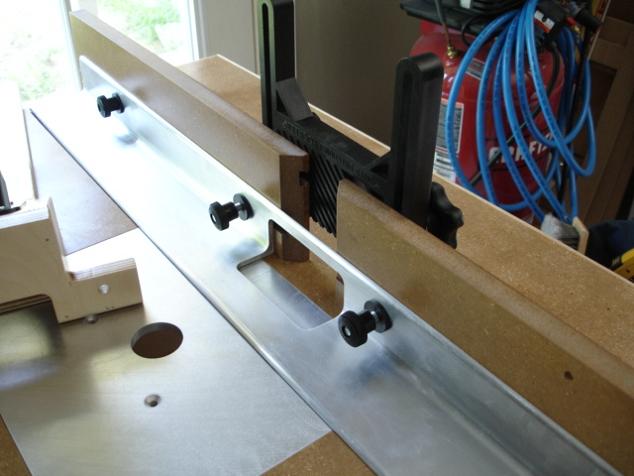

                    Not sure if this is the route you want to go but I ended up making one out of a quarter inch sheet of aluminum for less than $5. Actually I made two, one with a standard opening for the bit and one with a bigger opening. It was very easy once I got the templates measured and made.
                          Ryan,
                          Which exact product did you get from these guys? And then, i guess you cut the plate to the correct measurements on your table saw, and left the corners square. Did you do anything for a starting pin? Did you do anything for leveling? What kind of finishing did you do to the aluminum after cutting/drilling/taping?
                          -Pakaderm
                          • ryan.s
                            • 785
                            • So Cal
                            Originally posted by Pakaderm
                            Ryan,
                            -Pakaderm
                            Pakaderm - I first made templates for the opening on the table and a template for the insert out of mdf to get an exact fit. Once the templates were done I bought a couple pieces of 1/4 inch aluminum plate which was the approximate size of the insert. I trimmed the plate so that it was slightly oversized using the bandsaw. I taped the mdf template using double sided carpet tape then flushed it up using a router and a flush trim bit. I can't remember exactly the type of aluminum that I bought but it was from the remnants pile.
                            In terms of leveling, I measure the depth of the plate and used that to route out the opening. I could of added leveling screws but didn't think it was necessary since the height was pretty close. Just used a little bit of masking take on the underside of the insert to shim the height so that it's flush with the table.
                            I didn't use any sort of finish on the aluminum, just sanded it down with 220 grit sandpaper then applied a couple coats of butcher's wax after the insert was on the table.
                            If you want more pictures of the base plate, fence or the table itself let me know. Just another alternative to buying a base plate. Hope this helps.
