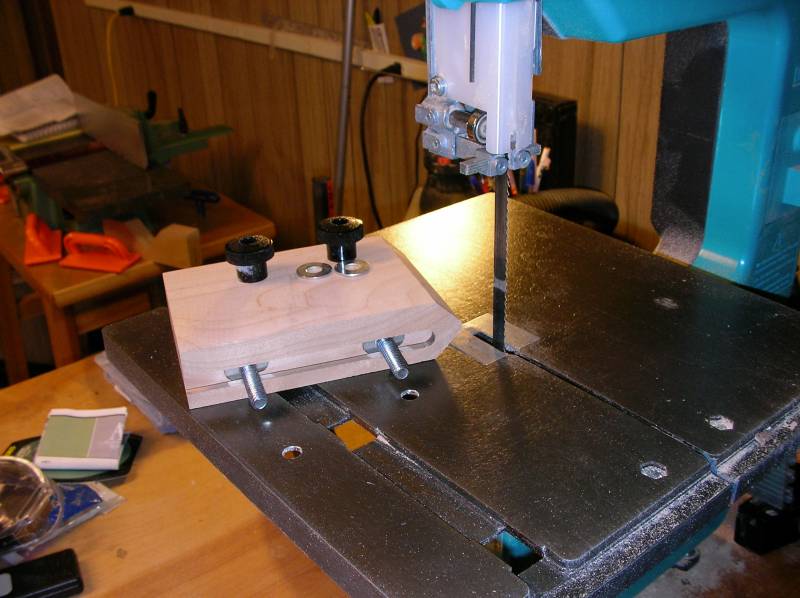

    I can't believe that I drilled two 5/16" holes in the table of my Inca bandsaw to accomodate a single-point resawing fence.
    Sure, there were a million other options for attaching a fence like this (including just clamping it). But, none of them offered this level of simplicity or precise adjustment.
    I've just never done anything like this to a tool before. Sure, wear and tear is unavoidable. But mods I've made to machines in the past have always been completely reversible. And to make matters worse, this little 9" bandsaw has a resale value of over $750 on eBay, believe it or not. Or at least it did, until I drilled holes in it.
    I wish I could have two bandsaws and dedicate one of them to resawing (like David Marks). This is the next best thing, though. With a single-point fence I can resaw with whatever blade happens to be installed on the saw w/o having to worry about compensating for drift.

      I've seen this done but not into the table, but as a whole add-on to the top of the table (Rockler sells a kit for one; Loring has done a nice one IIRC) with the point built into or slipped into a slot.
      That being said, two questions:
      First, why on the outside of the blade? I don't think I've ever seen it done on that side, but I can see doing it so in order to make it easier to get on/off.
      Second, why not a more "involved" device that sits in the miter slot? You can get or make "expanding" holders for the miter slot, and make a setup that uses that.

          (1) I woulda built an accessory table "topper," but my max resaw is only 5.5" now. I'd hate to lose any height.

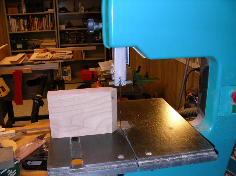

          (2) On the outside of the blade: If you look at my saw, you'll note that it is "backwards" when compared to other bandsaws. The pilar is on the right (facing the front of the saw) rather than the left. I'm left-handed. I've found that it is much easier for me to control the stock when using my right hand to push the stock against the fence, and my left hand to feed the stock. So this feels better to me. And you're right, it is easier to install/remove.
          (3) Finally, on the more "involved" device, I gave it a lot of thought and decided I didn't want to get complicated. Just wanted to keep it simple. I coulda modified the existing fence. But this is rock solid and extremely precise.
          I've already cut some 3" white oak into 1/16" slices (I'll never actually do that in real life) and this works perfectly. A hole-drilling compromise, certainly, but one I was willing to make.

                        Could you have drilled a hole in the standard fence and attached the "point" to it with a counter-sunk bolt on the point side and a quick turn knob on the other?
                        I use a "point" fence also and a metal one comes this way on my SC BS and the Jets. Works great as the polished metal "point" has a flat spot on the back that allows it to sit flat on the standard stock fence when in use.

                            I agree. But having tried both methods, a SP fence is better for my style of work. I don't want to take time to switch blades and check for perfect alignment each time I want to resaw. I know I would get better results (only slightly) if I did, but the wood still needs to go through the planer anyhow.
                              While I see your reasoning, the pivot point is usually on the arm side of the saw (wether right or left handed) so that it doesn't restrict the size of stock you can resaw. What if you get a 12 inch wide piece of 16/4 stock?
