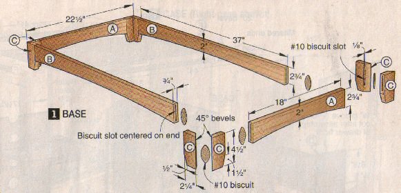

              I scanned the diagram and uploaded here.
              Looking closely at the mitered joints between the two halves of the legs, maybe a pocket hole is not possible...?
                Are you a new woodworker (I kind of assume yes if this is the first project your wife has commissioned since my wife dictates 95% of my projects)? If you are this may be a bit much of a project.
                If you have a little experience then certainly go for it! I believe that for the average woodworker this design is overly complicated. If were you I would simply use 8/4 material to create a 2 x 2 leg/foot and use pocket hole joinery (PHJ) to connect the rails. I since you are using a thicker material with the 8/4, you can cut a deeper stronger PHJ and use 1.5" fine washer head screws instead of 1.25" used in 3/4 wood. I believe that joint would be more than strong enough for this project. I also believe others are going to start howling about the Wood Mag review of joinery which cites PHJ as being inferior, to which I say bbllllaaaaaa. However, I will concede with the joinery purist that I would personally use 8/4 and M&T joint myself, however if you are not that far along the PHJ will be fine.
                You mention using the slot cutting bits for BJ. I understand how you can use a router and a slot cutter to work on the edges of material, but how are you going to cut slots in the middle of a piece of plywood?
                I wonder whats the point of the 3/4 mitered at 45 and BJ'd together? It seems like extra work for less strength than using 8/4.
                BTW, I really like this design.
                Note: I also suffer from sleep disorder and took Ambien about 30 minutes ago so this may just whole thought process may be a hallucination.

                      Jeffrey, am i new to WW? hooboy, No! i have been doing this all of this year! well, seeing that this time last year i did not know a rip-cut from a cross-cut, i guess you could call me a novice WW and still make me proud!
                      That said, i have got the guidance of an excellent teacher at my local community school, and have managed a couple of simple tables, stools etc (and Norm's adirondack chair) and did manage a couple of passable M&T joints along the way. Now i want something challenging, so this. And i am guessing worst case would be that i would be re-doing a couple of the pieces, and am ok with that.
                      But you have touched upon the one puzzle i myself had - wouldn't it be stronger to use thicker stock for the feet? But maybe this (miter-jointed) would look nicer?
                      The plan calls for placing the plywood on this base and just gluing it. Again- is that strong enough...?
                      When you say you like this design, is that aesthetically, or for its strength, or - what?
