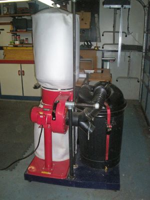

                  Small, cheap and came with the low micron bag. Not a Onieda, but gets the job done....
                  Good luck..

                      Originally posted by Bulkley
                      I'm interested in that cyclone; but I don't have the space and don't want to spend the money. I have considered one of those ashcan cyclones, but again there is a space issue. My DC has to be mobile, because I connect it to my router table as necessary.
                      Anyway, everytime I open up my DC for cleaning, I am struck by how thick the dust is on the inside of the filter. A lot of the dust is not separating. There are no baffles or devices of any kind that would encourage particle separation; air just zips in and up through a nine inch hole. Since they can make a cyclone small enough for carpet cleaning, I see no reason my DC can't be retrofitted for better separation. I would think that even a smaller opening would help.
                      Any thoughts?
                      That's why the Jet, Penn State, Grizzly versions of the pleated canister filter have beater flaps on the top filter to knock off the fines and drop them into the catch bag below.
                      Also a neutral vane can help spin the dust in a cyclonic fashion so that more separation occurs dropping stuff into the bag below.
