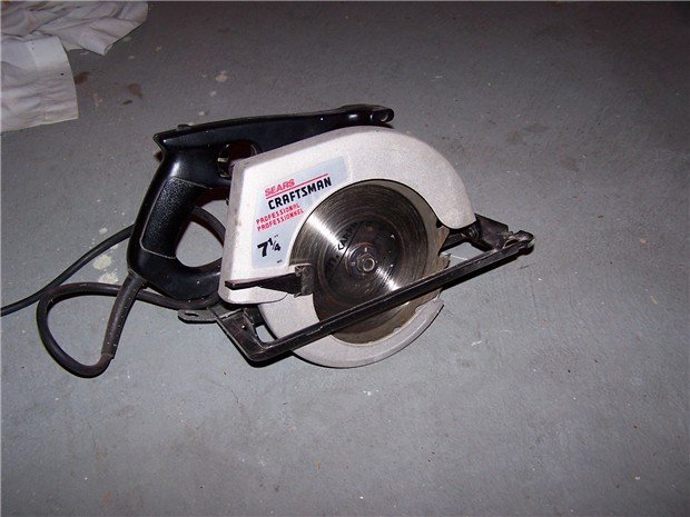

    Hey Everyone;
    My Dad recently gave me some of his old tools. He wasn't a woodworker by any means, but one of the items was this Craftsman 315.218250. It's about 17 years old and a hefty big beast, but hasn't been used much. Compared to the unit's I've seen at HD & Kent, it's a tank.
    As a starting out woodworker I was going to get a good CS for sheet stock before it goes on my soon to be mine, BT 3100. I'm wondering if this saw with a good blade would be OK for what I'm intending to use it for. I've heard that Craftsman stuff is good, depending on the vintage, and would appreciate any opinions/experience I can get here. (Before I go out and spend money on a blade and ruin my first sheet of stock, just to find out this model was/is a lemon.)

    Well, don't really know much about that saw, but 7-1/4" blades are usually real cheap and you're going to need one anyway, so buy a blade and try it on some scrap wood.
    It's as good as it works for you.

            You can do a few simple checks to see if this saw is an obvious dud or not:
            With the saw unplugged and a blade installed:
            1. Grab the edge of the blade and try wiggling it perpendicular to the cutting direction - you're testing the arbor bearings for slop. Any motion here will cause a wide, sloppy kerf.
            2. Slowly turn the blade forwards and then backwards. You'll "feel" the slop (lash) in the gears as freeplay each time you reverse direction. Ideally there would be zero slop but most saws have a little. If the slop is small (say under half an inch at the blade tips) the gears inside probably are healthy.
            3: Just spin the blade, listening to the saw. Worn internal bearings will have a marbles-in-a-can sound. You may feel a "gritty" feeling in the blade as you turn it too if there are bearing issues.
            4: Bottom plate: how firmly does it lock into position? Is there much slop at the pivot points? Using an accurate protracter or a plastic drafting triangle (cheap and amazingly accurate) check the 90 and 45 degree marks. See if the long edges of the plate are parallel to the blade too.
            Then remove the blade, plug the saw in, double check the bottom plate is tight... while holding the saw in the air turn it on for a couple seconds. Look at the back end of the motor, through the cooling vents, watching for sparks. A few sparks visible is normal. If you see a blue ring of sparks, or if sparks are flying in all directions, there is a motor or brush issue that needs attention.
            Many of those older Craftsman tools were quite good; I wouldn't be surprised if that saw was perfectly usable this instant. If it were mine, I'd probably open it up and check the grease (it's probably dried out by now) and the length of the brushes. Both are easily replacable before problems occur. As long as the arbor bearings don't have any slop it should cut decently when equipped with a quality blade.

              Thanks much for the info....especially your test procedure, MPC.
              1. No sideways motion at all.
              2. Slop when reversing direction...less than 1/16".
              3. No marbles in the can, however you're probably right about the grease.
              4. Bottom plate is tight. I had to adjust the screw for the 90 position, but it's right on now as is the 45.
              Blue sparks for the first instant at startup, but then nothing I could see. Looks like a couple of good blades and I'm in business.
              Thanks again, everyone, for the advice.
