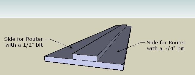

          Originally posted by Roger on the Rock
          Sacherjj...do you have a picture of your router board?
          I don't have a picture of it, but attached is a SketchUp of it. It is basically a two sided saw board, with the edges cut with the router for the setup with two bits I commonly use. I can then line up the edge with one side of the dado I am making and run the router. When I need to use a different bit, I use either side (less than 3/4" but greater than 1/2", I use the 3/4" side and less than 1/2", I use the 1/2" side) and offset it from the line the correct amount.
