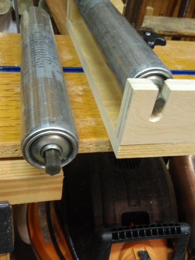

                I know this thread is 5 years old, but I have made the following improvement:
                The PVC pipe rollers were the weak part - they worked fine with 1x4 and 1x2 but 2x4 was a strain and 4x4 was very hard on it - the 1/4" dowels and the wood in the center of the PVC was too soft (poor choice on my part).

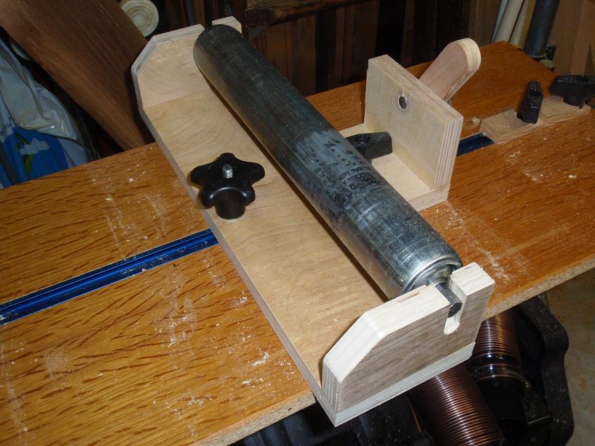

                Anyway, about 6 months ago I picked up some industrial used/surplus ball bearing conveyor rollers with this intention:

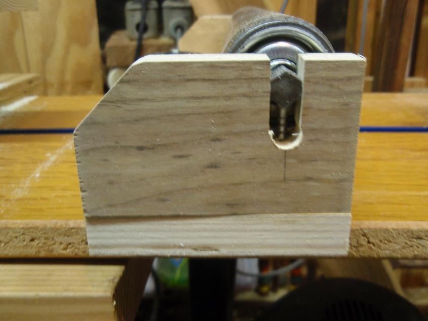

                Click on the thumbnails for a full size pic. The first pic shows the roller, the second pic shows the roller assembly, and the third picture shows how i adjusted the elevation using a screw in the bottom of the slot. This works really well. I sort of need to capture the roller because right now it will fall out of the holder slot if turned upside down...

                  Good upgrade, little overkill no? It doesn't look like you have much room to drill and insert a wooden dowel to lock the roller in...perhaps a nail used as a pin coming in from the side?
                  Would a small block of wood with a "v" cut out and inserted into the top with the v face down over the square peg of the roller with another thin piece of wood stitched across the top work?
                  Since you have had your setup for several years now, how much do you use it and is it worth its footprint in your shop? Or do you normally stow it and retrieve when needed?

                          Yeah, my original thought was a locking dowel or screw - for some reason i though the support should be lower than the roller so that the workpieces wouldn't contact them under normal use. I do want the lock to be snug, not let the roller move up and down once the height is adjusted, and finally, to allow later height adjustment and then retightening. I do have some ideas.
